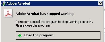

I have three different computers with three separate copies of Acrobat Standard XI and they all seem to be crashing shortly after launching. This issue came up a few days ago and I'm at my wits end trying to figure out the solution. Two of the computers are Windows 10 so I originally assumed it must be a Windows update but I also have a 8.1 computer that is experiencing the same issue. I'm getting the following error in Event Viewer:
Faulting application name: Acrobat.exe, version: 11.0.0.379, time stamp: 0x505fd1ce
Faulting module name: Acrobat.dll, version: 11.0.0.379, time stamp: 0x505fd1b6
Exception code: 0xc0000005
Fault offset: 0x00c57530
Faulting process id: 0x46b0
Faulting application start time: 0x01d58a71b89c9a68
Faulting application path: C:\Program Files (x86)\Adobe\Acrobat 11.0\Acrobat\Acrobat.exe
Faulting module path: C:\Program Files (x86)\Adobe\Acrobat 11.0\Acrobat\Acrobat.dll
Report Id: 13897b30-eeaa-4b0d-8fc1-a01825e9c497
Faulting package full name:
Faulting package-relative application ID:

    November 12, 2019
    Hi Team,
    We are faing the same problem on windows 2008 sever, The insatlled Adobde acrobat XI standard version is 11.0.00. Below is the error reported in windows event logs.
    Faulting process id: 0xb68
    Faulting application start time: 0x01d59944053f236b
    Report Id: 513a2f2e-0537-11ea-8231-00505696433a
    I tried to heck for availble updates but it says updater is already running.
    Could you please help?
