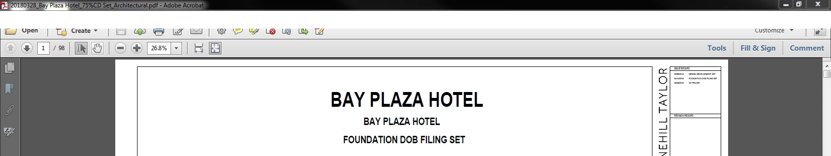

When I open up a PDF in Acrobat, the toolbar gets cut off and I can't minimize or close the window from the top. Is there any way to fix the issue?
Correct answer Frank9482
Win+Ctrl+Shif+B fixed the same problem.
Thank you!

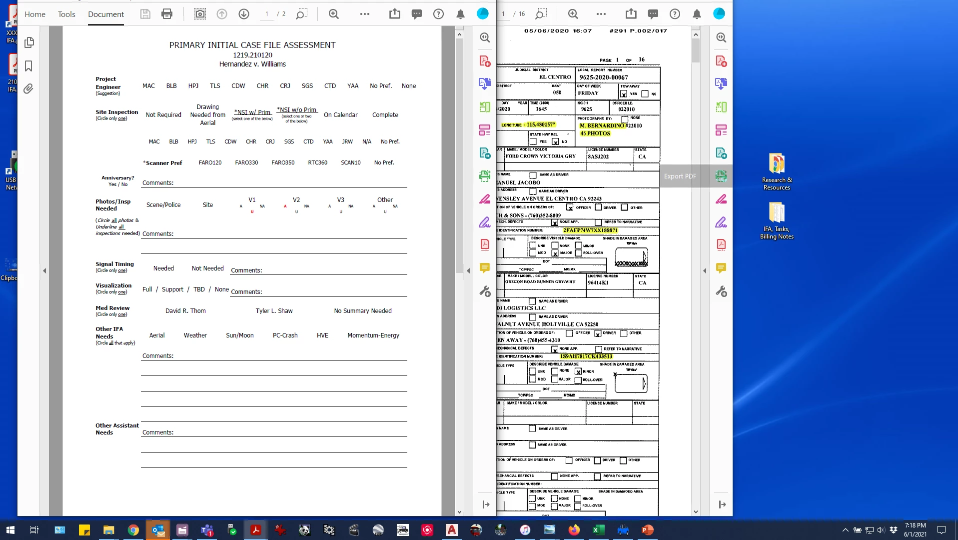

October 4, 2020
I went to the window menu inside Adobe PDF and selected tile, then horizontally and it worked for me.

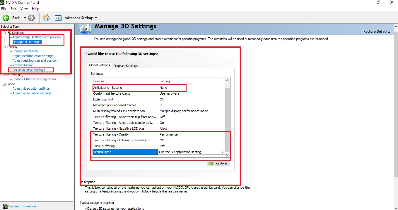

ls_rbls
August 20, 2019
See also if by following the recommended settings by the graphics driver device manufacturer helps
See slide below and change or adjust some of the settings so that you don't have to refresh manually everytime (perform with common sense, educated guessing and caution of course)
In my example above I am using Nvidia Control Panel

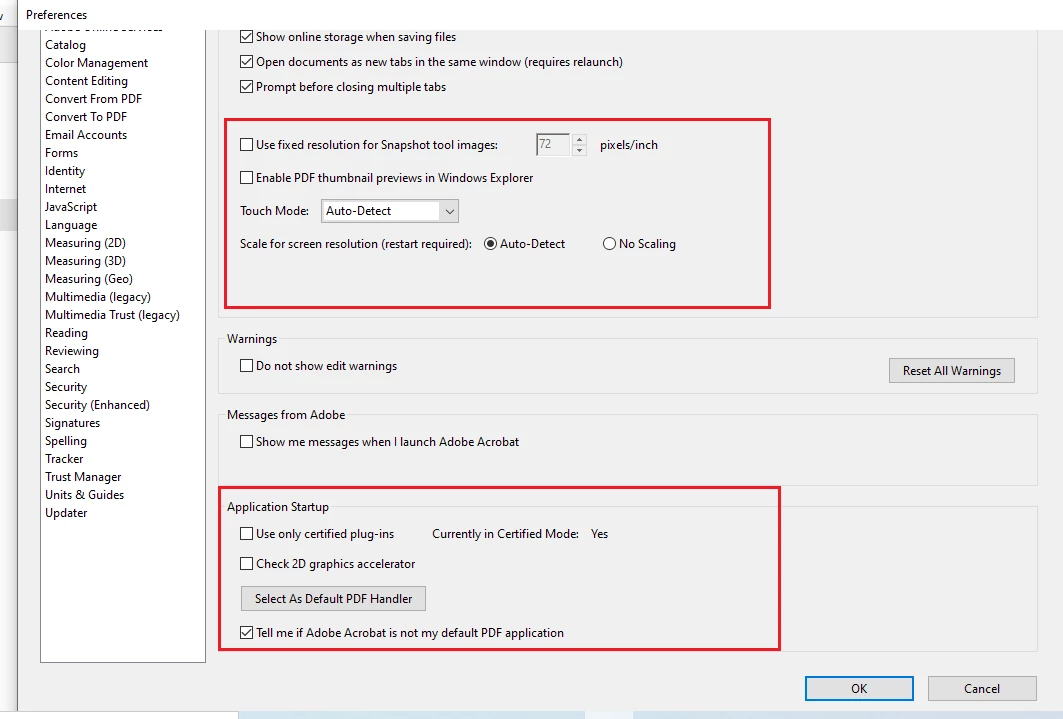

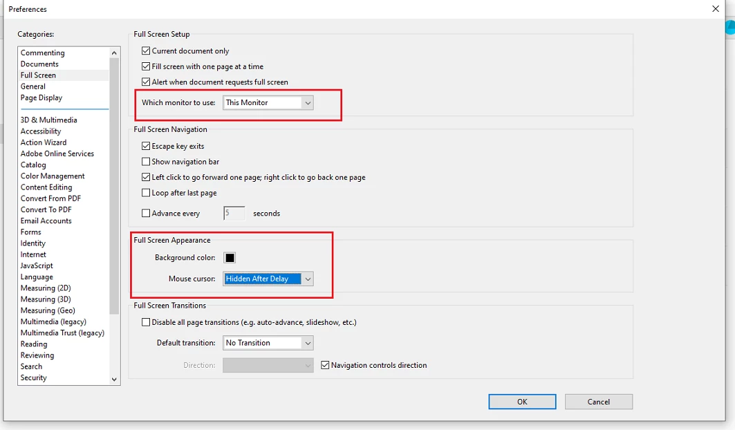

ls_rbls
August 20, 2019
In another thread I was also recommending to another user that after upgrading my product to the latest version some additional configuration settings appeared and bugs were fixed.
But in the images below you can gathere as an example additional insights by checking from within the Adobe "Preference"-->
"Page Display"
Also here:
