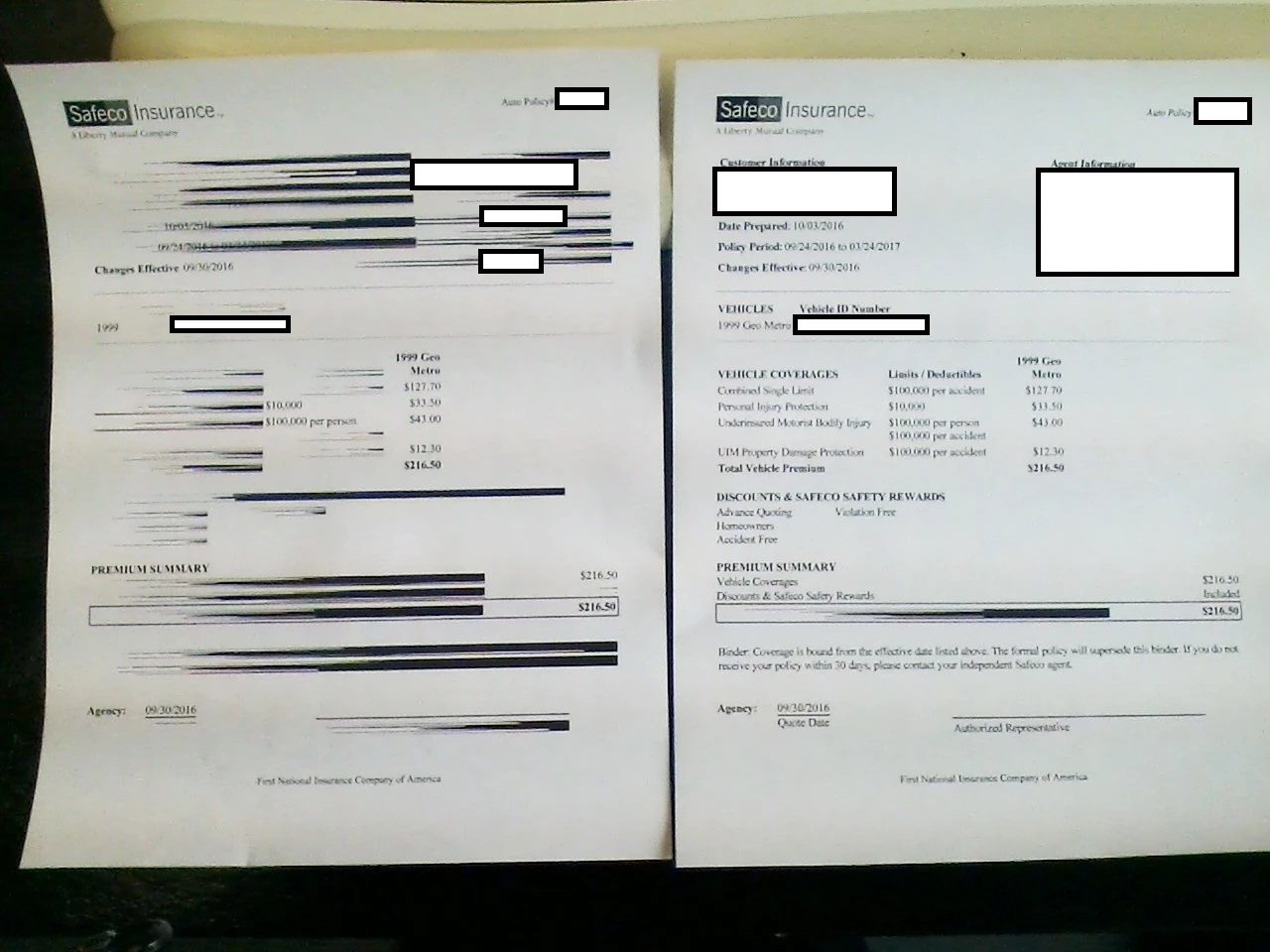

Thank you Tariq for your hard work in trying to fix the problem. I did the workaround and it is much much better although not completely fixed. It will do for now as we can see much more information on the printout than before until Adobe has resolved the issue.
Thank you again
Here is an image for your info, excuse the blocked out white images as there was private information in those areas.
** Edited, I spoke too soon, another page was printed out with the first page results...
