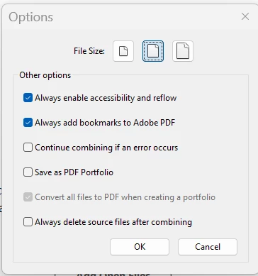

I use Adobe’s built-in ‘Combine Files’ feature via. Tools > Combine Files.
For the “structure” bookmarks, the bookmark type can vary. Usually, it is all the “ structure” type (what it should be when combining), sometimes it is all ‘Standard” type (which it shouldn’t be, but is what I want it to be), and then there are occasions when they are a mix of both types.
The thing I find strange is why it would do this when everything is scanned through the same scanner and should all be the same format when combined. There is no additional elements or sources to inherit as it would lose it all when it is scanned in as a completed new document as far as I know.
I don’t manually add additional bookmarks either but if I did, they would appear as my preferred ‘standard’ type. I’m not sure if the combine options matter but here is what mine is set to when I combine them.

  1. Does your scanner software run OCR (text recognition) or add any tagging automatically when it saves the scan, or is it a plain image-only scan until you open it in Acrobat?
  2. When you look at Options in Combine Files, is "Add bookmarks to Adobe PDF" the only bookmark setting checked, and are you always combining straight from Tools > Combine Files (not a saved Action or preset)?
  3. What Acrobat version are you on (Help > About Adobe Acrobat), and is it the same version now as it was last week when you saw the other result?
When Acrobat's Combine Files feature builds bookmarks automatically, it attaches them to something called a "Structure Element" in the PDF. That's what gives them the "structure" look and takes away the option to right-click and choose "Set Destination." Bookmarks you add yourself with Ctrl+B (or Right-click > Add Bookmark) don't have that structure link, so they show up as the plain "standard" type you prefer. You can read a bit more about how tagged/structured bookmarks work here: https://adobe.ly/4cGc30t
That explains why the two types exist, but it doesn't explain why the same files would combine differently on different days; that's not expected, since it's inconsistent even with identical scans, could you please share a small video recording of the steps you are taking and the issue as it occurs along with the diagnostic logs as described here https://adobe.ly/3S3C2Il so that we can get it reviewed by our development team.

  1. As far as I’m aware, we considered using OCR but decided not to as it was too time consuming converting everything so they should be image-only files, except for records that we have just digitally dragged into the records so it actually isn’t 100% scanned records only.
  2. The first two options are ticked in the settings we use. We do not use any other presets when combining files. We simply just go Tools > Combine Files. We don’t get bookmarks to appear otherwise.
  3. It might not be the same, I think I used the ‘repair installation’ option afterwards to try and fix it and checked for updates since then…
