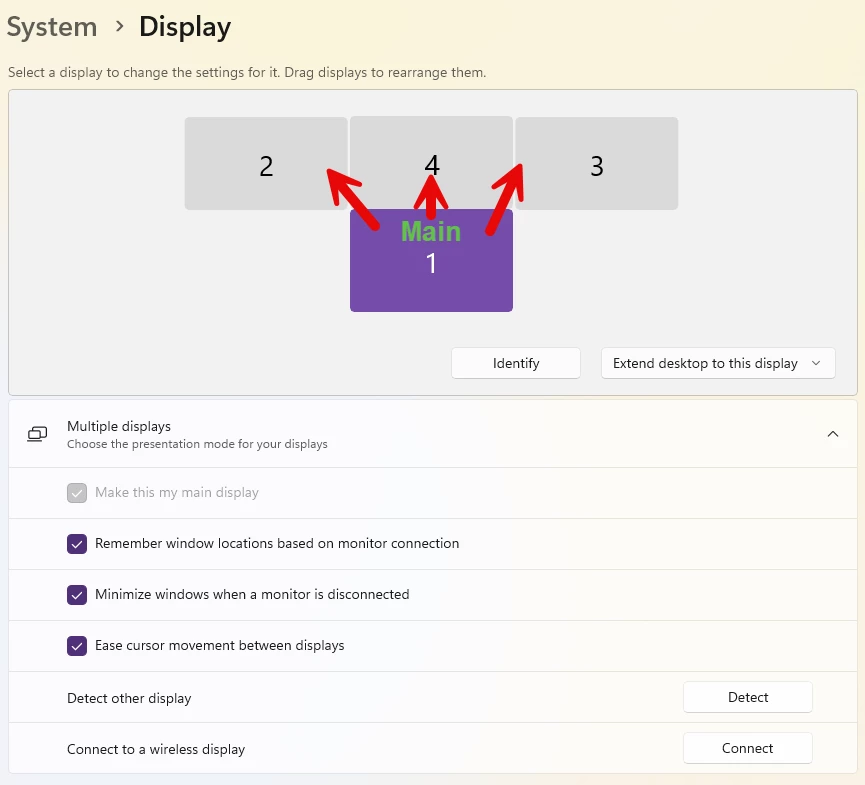

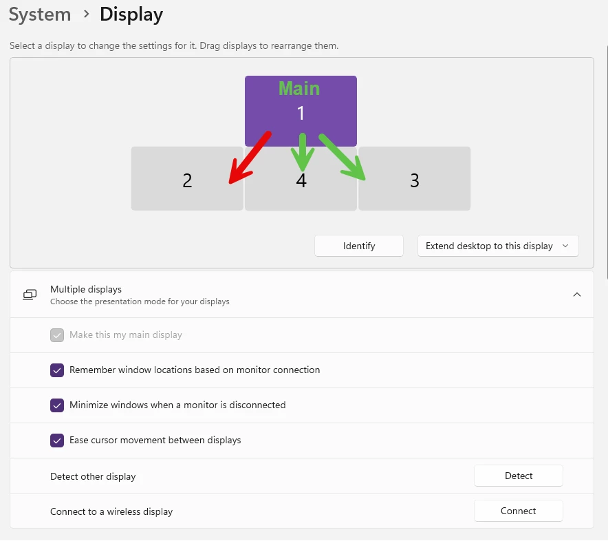

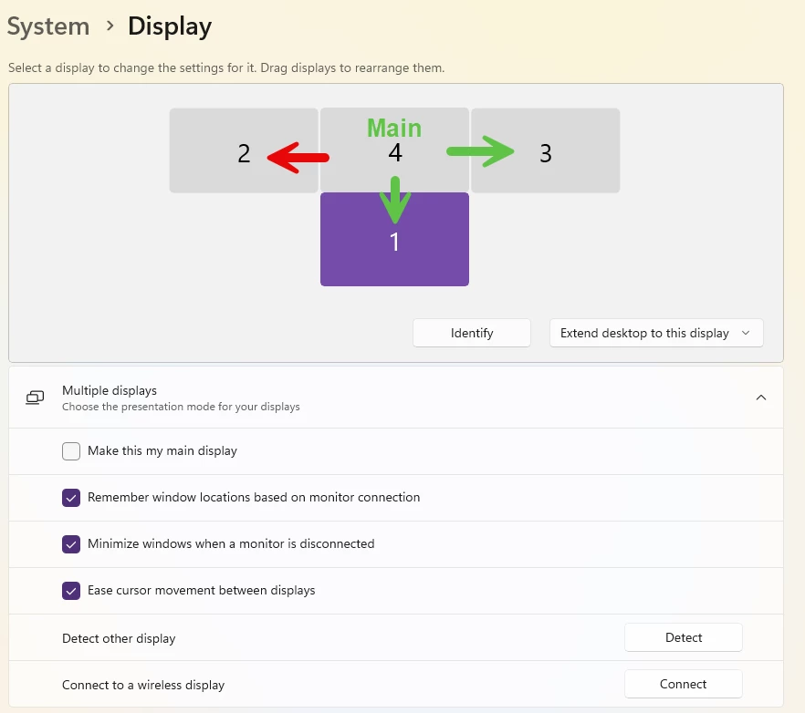

Ultimately, this is what we identified was causing the issue for her, and allowed me to reproduce the issue on my computer and others as well: On a Windows 11 computer, if you have more than one display, we had to set the far left , and top most display as the “Main Display”. If your “main display” is below or to the right of any other displays, it seems to break the click and drag as soon as you drag past the left or top edge towards the other display. I’m finding it difficult to explain that properly, so below are a few images showing display layouts I tried, and the results I received for those layouts. I indicate which display is set as the Main Display; I use a green arrow to indicate which screens I can drag to for that layout; and I use red arrows to indicate the screens I can’t drag to with that layout.
Hopefully someone else can use this information to actually solve the root cause, but in the meantime, my workaround for that user was to set her far left display (she had 3 total) as the Main Display, and that allowed the drag and drop feature to work on all 3 displays.

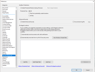

I found a solution. You'll need to disable or turn off the Protected Mode
1. Edit->Preferences->Security (Enhanced)
2. Under Sandbox Protections, disable the Protected Mode
3. Restart the Adobe (close and open the program)
4. You're back in business

I managed to fix it by turning off protected mode & making sure it was turned off for startup also.
THEN I added my folder, the entire documents folder in my case, to the privledged lications section on the same settings page as above. I then restarted arcobat completely.
