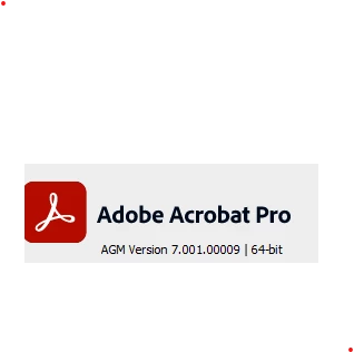

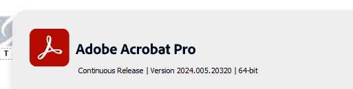

Have there been any updates on this issue, or issue with encoding errors?
I'm trying to 508 a data sheet with wet signatures that was scanned. The company logo symbol, the chemical structure, and other items are generating encoding errors. I've tried editing the Acrobat file to make sure it is using fonts Arial or TNR. So frustrating. Acrobat Versions below.

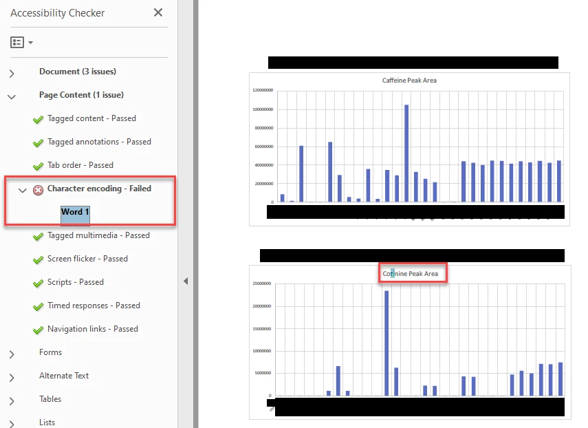

May 3, 2023 3:32 PM UTC
Below is an instance where the graphs were originated from Excel and pasted as pictures into Word. From the Accessibility Checker in Acrobat Pro 2020, you can see where the encoding error is picking up text from the bottom picture. I confirmed it is a picture, just like the graph at the top. Why?  This page was converted from Word to PDF; no scanning or OCR.
Thank you.
