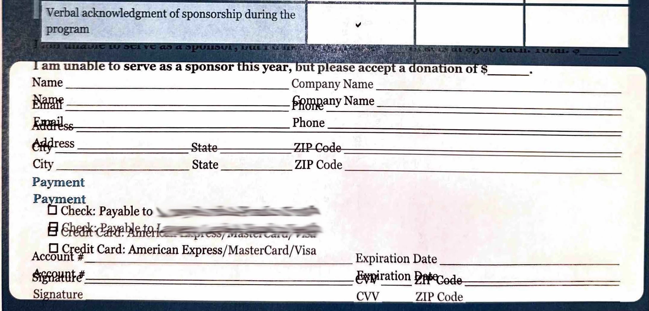

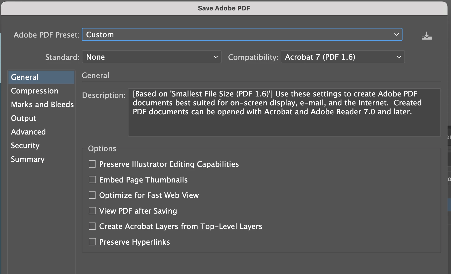

I know I’m late to the game here, but I found this page while searching for a solution to the same problem, I believe: I created a document in AI that included a form, PDFed it, and sent it to the client I created it for. The client said she could see the form page fine on her screen, but when she printed it out, it looked like a double exposure (what you could call “ghosted”).
My solution: I opened the doc back up in AI, got rid of any layers (hidden or not) that I was no longer using*, and then when I saved the file as a PDF. When the Save Adobe PDF window popped up, I made sure that that  ALL of the checkboxes in the General tab were unchecked. This worked a charm!
*I’m not sure that I really needed to delete all of those hidden layers, but I’m glad I did!
This is how the double exposure looked before fixing.
Make sure ALL the boxes are unchecked.
