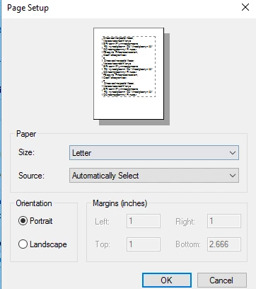

The problem we face: Acrobat insists the documents are in Letter format. I therefore have to go to: Print -> Page Setup and change the paper size from Letter to A4 every single time I have to print something.
As you can imagine this is very annoying and time consuming.
Question: Is there any way to change the defaults of this dialog? I want Acrobat to remember we are in a country which, 99.9% of the time, uses A4 (or any other DIN format).

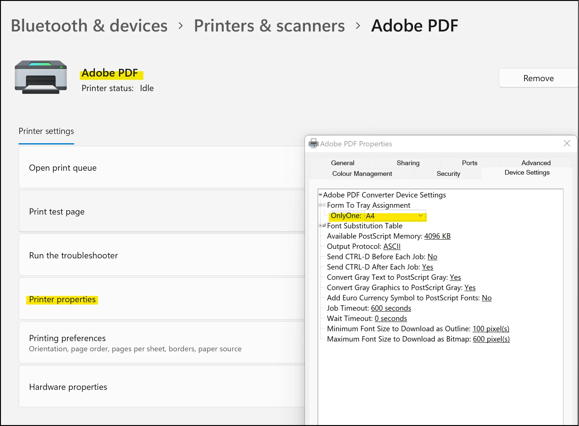

I found a solution for my own settings. Hopefully this works for everyone else.
1. Go to your Printer & scanners (Windows; on Mac similar) and select Adobe PDF.
2. Click the Printer properties option.
3. On the Adobe PDF Properties pop-up window, go to the Device Settings tab.
4. Change the paper type from Letter to A4.
5. On the General tab (of the same pop-up window), check that A4 is shown instead of Letter.
6. Click the Apply button.
7. Test from Word, Excel, etc. (e.g., save as PDF)

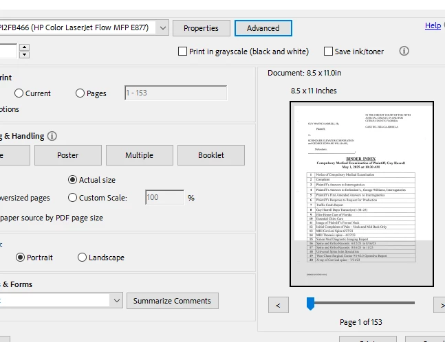

I am not sure if you can possible help with this but some how everytime I try to print, it cuts off the put of my PDF document - where the grey area is.  I have tried everything and cannot figure out what to do.
Thank you for any help!!
ls_rbls
April 22, 2025
Hi @ashley_1246 ,
In the printer  dialog shown in your screenshot, What happens if you select "Fit" instead of "Actual Size"?
Also, note in the slide that all margins should be 1" inch. The bottom margin is set at 2.66 inches, which you can modify manually, but it is not performed directly from the Adobe PDF Printer dialog.
I am curious if this is happening to all the PDF documents that you print or just one particular PDF?
See this old discussion:
https://community.adobe.com/t5/acrobat-discussions/preflight-pdf-fixups-how-to-scale-pages-to-us-letter-not-a4/m-p/12004003
Scroll down on that thread  and see the tips I pointed out to one of the community members on how to do that manually.

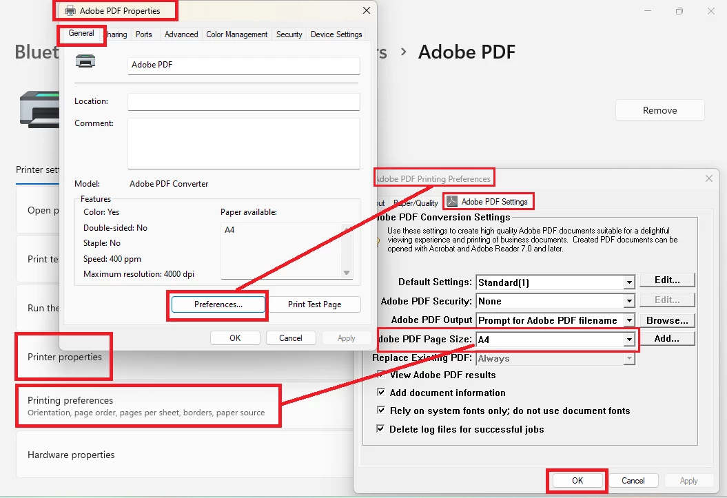

go to preference settings in your printer, change the paper size, ADOBE will check this when you print.
But any aplication ll use the paper size your choise here.

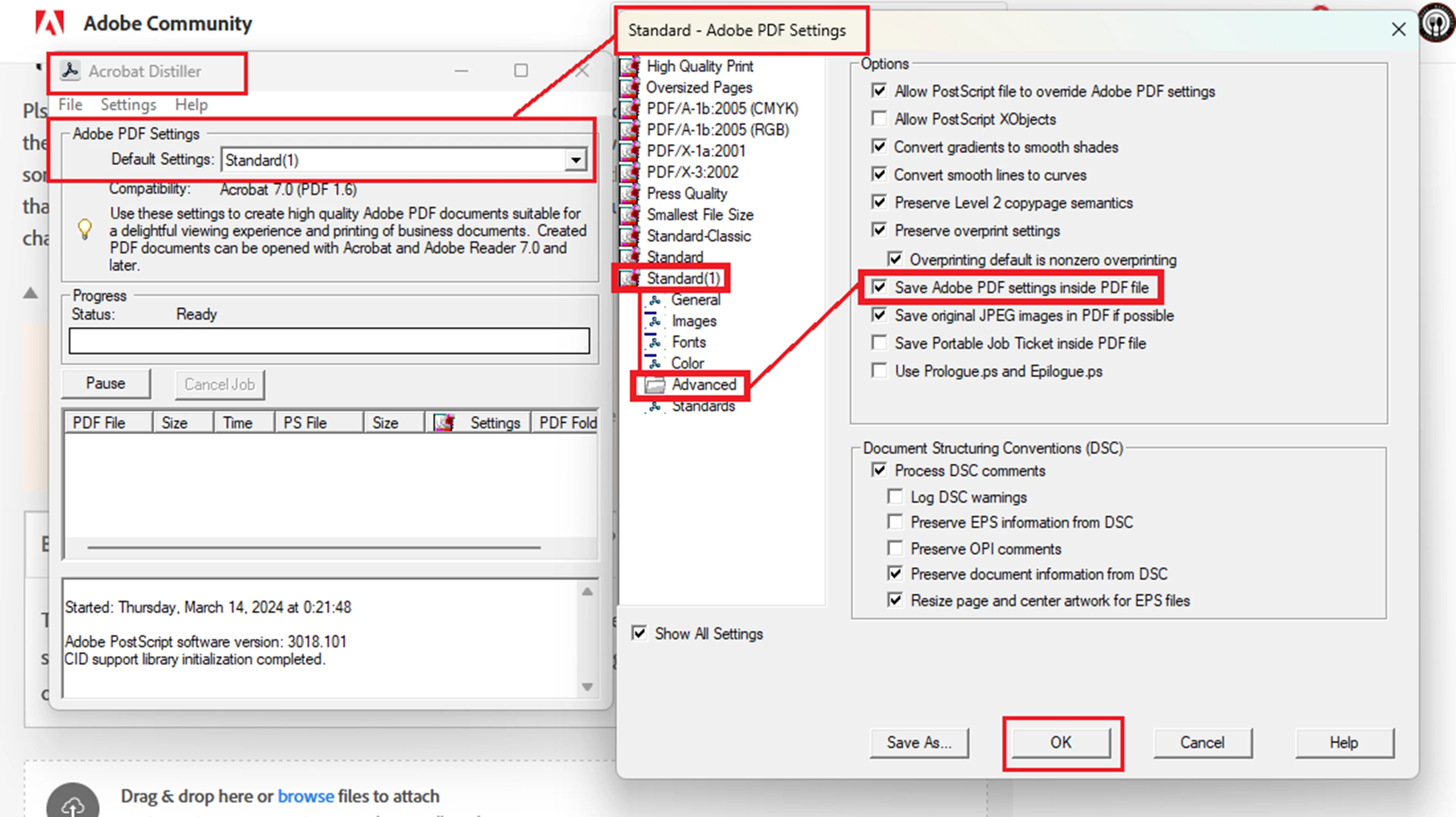

@markv69409834  I agree with all of your observations.
If on Microsoft Windows, I've been able to work around that by customizing the desired page dimensions in the Control Panel ==>> Printers & Scanners ==>> "Print server properties" as suggested by @JPN19
This is not done through printer sever configuration settings accessed with the printing device driver software. However, it seems to work fine for me for me if it is managed at the operating system level (i.e. if on Linux or macOS it can be managed through CUPS too).
The problem that you've observed also seems to be related to the default settings of the Acrobat Distiller as shown in the slide above.
In which case, a few things need to be manually tweaked there to prevent PDF documents from reverting to undesired defaults at printing time..
This articles add some interesting relevant insights to keep in mind:
There is a setting, for example, in the Advanced Options ==>> "Save Adobe PDF inside PDF file" that is not checked by default. Ticking that checkbox will ensure that every PDF document created with Acrobat will retain the customized Adobe PDF Settings and should remain intact until the user desires to change printing preferences at printing time.
See next slide below:

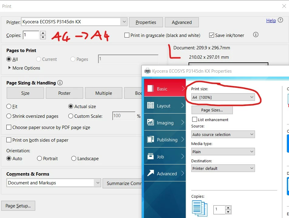

Hi Luke,
thanks for your reply and your help.
What you suggested is true, albeit only partially. Let me explain:
The default printer paper size is indeed set to A4. This means:
  1. The Printer does not complain every time regarding "Wrong paper selected..." but just prints the document.
  2. The document is scaled incorrectly because acrobat assumes it will be printed on Letter and scales it accordingly. then the printer driver takes over and re-scales the document so it fits on A4 paper. Please have a look at the attached images for comparison.
This means there is a discrepancy between the system-wide default print size and the assumption acrobat makes about the format of the document. I wish to change that.. permanently.
Cheers,
Simon
