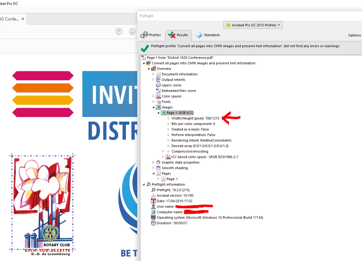

jf83971618  wrote
As its a pdf I can't then select one of the images to check for its res stats.
You can:

April 17, 2019
How do you know that doing this reduces the image resolution? Have you measured it?

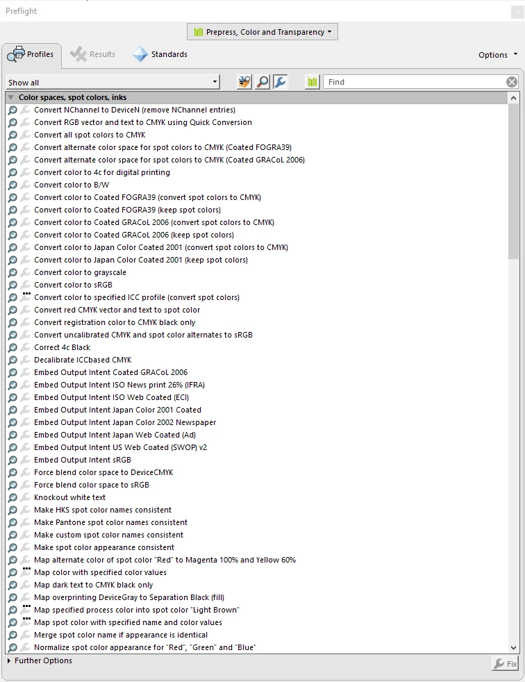

First of all:
If your printer is able to accept PDF X4 files, there is no need any more to convert to CMYK, avoiding an additional step. The RIP will take care of this.
Second:
Saving does not modify to CMYK. So I wonder what steps exactly your taking.
Third:
Consider using Preflight for the RGB to CMYK conversion.

all I want to know is how to stop acrobat doing anything to the images when converting to CMYK from RGB.
.Changing RGB images to CMYK images is a huge modification of the image, resulting in some loss of information. You can't simply take a RGB image and convert to CMYK and convert back to RGB and getting the same image than the starting image. You are doing a lossy operation with irreversible information change.
This said, I assume you only want to change RGB to CMYK and then print. That's OK, but there is a loss in information.
