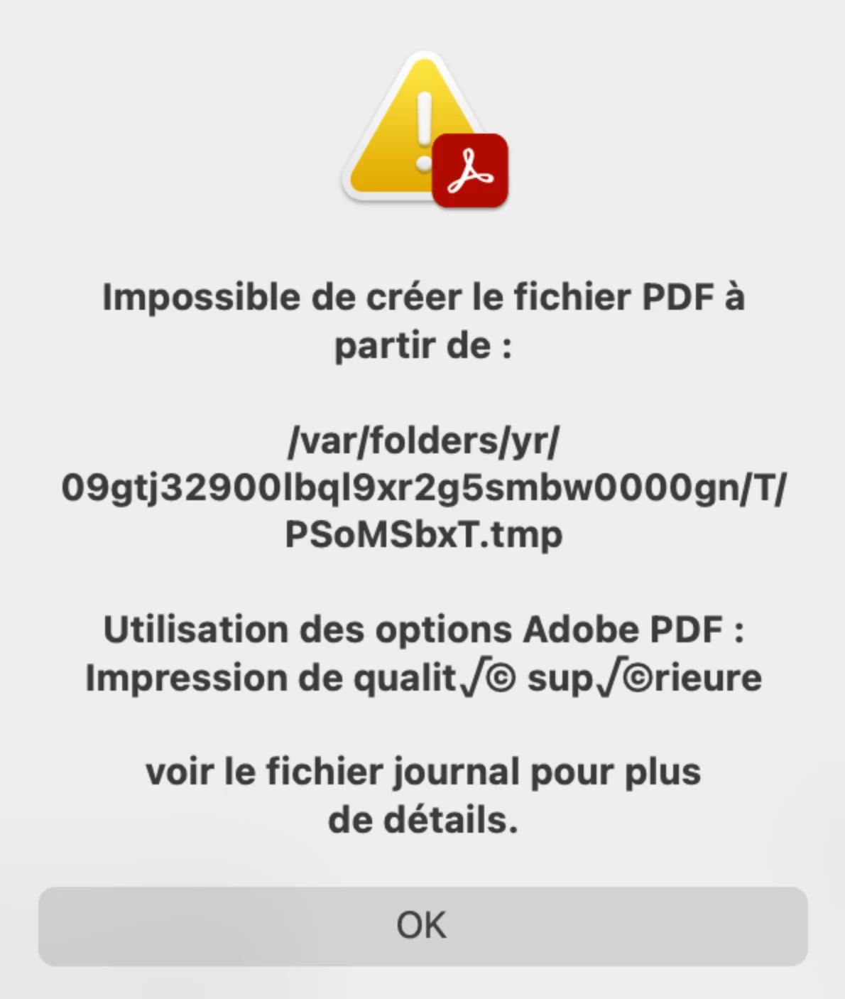

PROBLEME D'IMPRESSION AVEC ACROBAT APRÈS INSTALLATION SONOMA
Salut, après la mise à jour vers Sonoma, je ne parviens pas à imprimer dans Acrobat. Adobe Distiller s'ouvre automatiquement, puis l'erreur suivante se produit : Un fichier PDF ne peut pas être créé à partir du fichier
et tout est bloqué
Amal.

J'ai le même problème impossible d'imprimer des documents PDF depuis l'update Sonoma
Hi There
This issue is addressed with the recent version 23.06.20360. Please update the application from the help menu > Check for updates and reboot the computer once.
Let us know if you experience any trouble and need more help.
~Amal

Hi there
We have reported this issue to our engineering team and they are looking into it. In the meanwhile, you may also try to print the PDF as an image. Open the PDF > Go to Print > Advanced > Print as an image and see if that helps.
Also would you mind collecting the Adobe CC logs https://helpx.adobe.com/creative-cloud/kb/cc-log-collector.html , and print logs https://helpx.adobe.com/acrobat/kb/collect-print-logs-for-acrobat.html and share them via any cloud storage. Just upload the log file to the cloud and generate the link and share that link with us for further investigation.
~Amal

Hi All,
Thank you for reaching out, and sorry about the trouble caused.
The team is aware of the issue and is working on this.
In the meantime, please use the workaround: In the print dialog, click the "Advanced" button and choose "Print As Image". Check if that helps.
We will update you once the fix is available, and we appreciate your patience.
Meenakshi

Bonjour,
Pour solutionner temporairement ce problème, vous devez cocher dans Option avancée : Imprimer comme une image et ajuster le DPI au besoin. Ça fonctionne pour moi.
