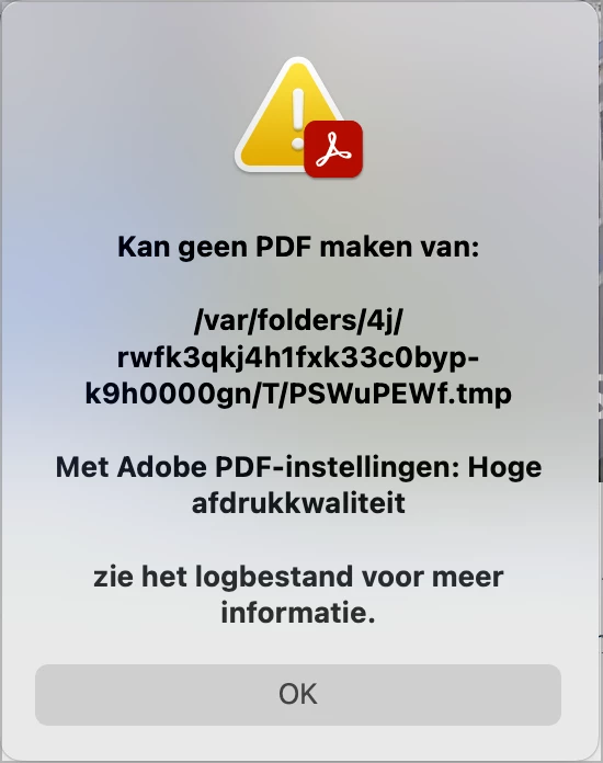

Salut, après la mise à jour vers Sonoma, je ne parviens pas à imprimer dans Acrobat. Adobe Distiller s'ouvre automatiquement, puis l'erreur suivante se produit : Un fichier PDF ne peut pas être créé à partir du fichier
et tout est bloqué

Same here... Adobe was apparently not ready for the launch for MacOS 14. Problem seems to be related to Distiller which immediately hangs and remains unresponsive. Adobe's log file is completely untraceable.

Hi @jean lucw31739276
Hope you are doing well, and thanks for reaching out.
Since you've mentioned that you've updated the OS, let's take a few steps to resolve your printer issue:
  1. Check for Updates: Make sure you have the recent version 23.06.20320 installed. Go to Help > Check for updates and reboot the computer once. Also, please ensure that your printer driver and firmware are up to date. Sometimes, outdated drivers can cause printing problems. Visit the manufacturer's website to download and install the latest updates.
  2. Reinstall Printer Driver:
    • Remove the current printer driver from your system.
    • Reboot your computer.
    • Visit the manufacturer's website and download the latest printer driver compatible with your operating system.
    • Install the new driver.
  3. Additional Troubleshooting:
    • Sometimes, printing issues can be specific to certain software applications. If you are experiencing problems while printing PDFs, you can try the troubleshooting steps described in the help page: Troubleshoot PDF Printing in Acrobat Reader.
These steps should help you resolve the most common printer-related issues.
If you continue to have trouble with the issue, please don't hesitate to reach out.
~Amal
