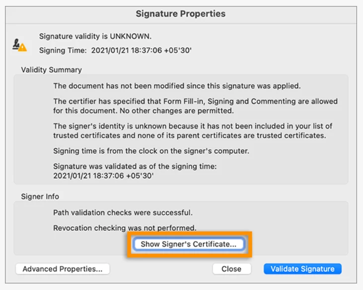

3. For more information about the Signature and Timestamp, click Signature Properties.
4. Review the Validity Summary in the Signature Properties dialog box. The summary might display one
    of the following messages:
  • Signature date/time are from the clock on the signer's computer - The time is based on the local time on the signer’s computer.
  • Signature is timestamped - The signer used a Timestamp Server, and your settings indicate that you have a trust relationship with that timestamp server.
  • Signature is timestamped but the timestamp could not be verified - Timestamp verification requires obtaining the timestamp server's certificate to your list of trusted identities. Check with your system administrator.
  • Signature is timestamped but the timestamp has expired - Acrobat and Reader validate a timestamp based on the current time. This message is displayed if the timestamp signer's certificate expires before the current time. To let Acrobat or Reader accept an expired timestamp, select Use Expired Timestamps in the Signature Verification Preferences dialog box (Preferences > Signatures > Verification: More). Acrobat and Reader display an alert message when validating signatures with expired timestamps.
 5. For details about the signer’s certificate, such as trust settings or legal restrictions of the signature,
    click Show Signer’s Certificate in the Signature Properties dialog box.

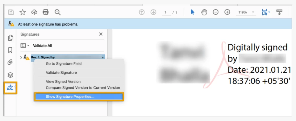

Trust a signer’s certificate
Digital signatures that were added using a self-signed certificate cannot be automatically validated by Adobe as the certificate is not in the list of Trusted Identities that Adobe uses to validate signatures. A self-signed certificate is a certificate that you have generated yourself using a third-party application. You will not be able to manually validate the signature until the certificate is trusted by Adobe. If you open such a PDF, you will see a warning At least one signature has problems.
Caution:
For security reasons, Adobe does not recommend adding a self-signed certificate, or any random certificate to Adobe's list of Trusted Identities.
To add the certificate that was used to apply the digital signature into Adobe’s list of Trusted Identities, do the following:
1. Click the Signatures button in the left-pane.
2. Right-click the signature, and then click Show Signature Properties.

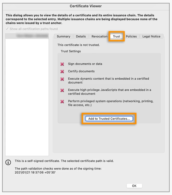

3. In the Signature Properties dialog box, click Show Signer's Certificate.
4. In the Certificate Viewer dialog box, click the Trust tab, and then click Add To Trusted Certificates.
5. Click OK in the trust settings pop-up dialog, and then click OK.
