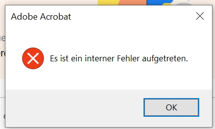

Feb 15, 2023 12:03 PM UTC
Dear Amal,
I have a similar problem with Acrobat, I think for two or three month now. Whenever I clicck in a PDF file in Explorer (I work with Windows 10) the PDF preview won`t work and stays blanc (first picture). On top of that a pop up from Acrobar appears, stating that there is an issue with Acrobat (second picture). And the bigest problem, quite often after clicking (not opening) a PDF file to move or rename it, explorer won`t respont anymore and crashes a few seconds later. I couldn`t recognise a pattern. Sometimes it crashes 5 times repetedly sometimes I am lucky and I only get the pop up.
If I open a PDF everything is normal and Acrobats works just fine.
So far I de- and reinstalled Acrobar 4 times, I installed every update the Adobe Cloud gave notice of and Windows is also on it´s current status.
Thank you for your support.
Sincerly
Jessica
Amal.
Feb 23, 2023 1:44 PM UTC
Hi @Jessica28419513h1ty
Hope you are doing well and sorry to hear that.
The issue, internal error occurred is a known issue and reported to our engineering team.
Would you mind collecting the Adobe CC logs https://helpx.adobe.com/creative-cloud/kb/cc-log-collector.html, Procmon logs (Win Only)  https://www.adobe.com/devnet-docs/acrobatetk/tools/Labs/acromonitor.html  and share them via any cloud storage. Just upload the log file to the cloud and generate the link and share that link with us for further investigation.
