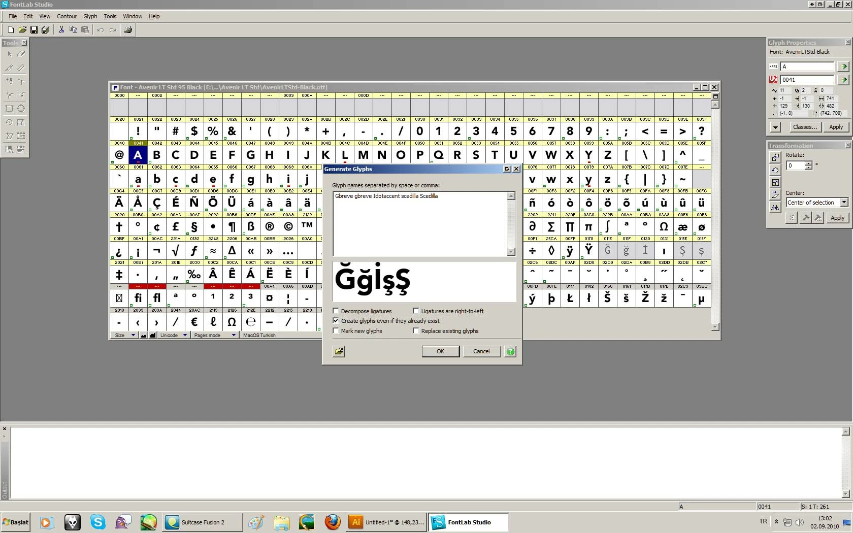

    Sorry for bringing up an old topic but I'm going  to be more spesific this time.
    As you can see the glyhps that I need is already added to the font structure and every time I need a font I have to add those glyphs one by one. I dont want to do it for every font that want to use. I want a shortcut to do them all.
    full size of the image;
    http://img265.imageshack.us/img265/8573/glyphs.jpg
