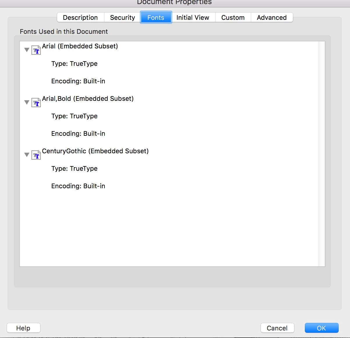

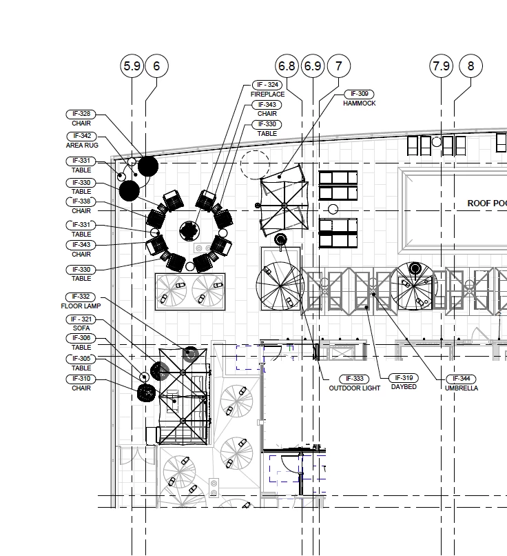

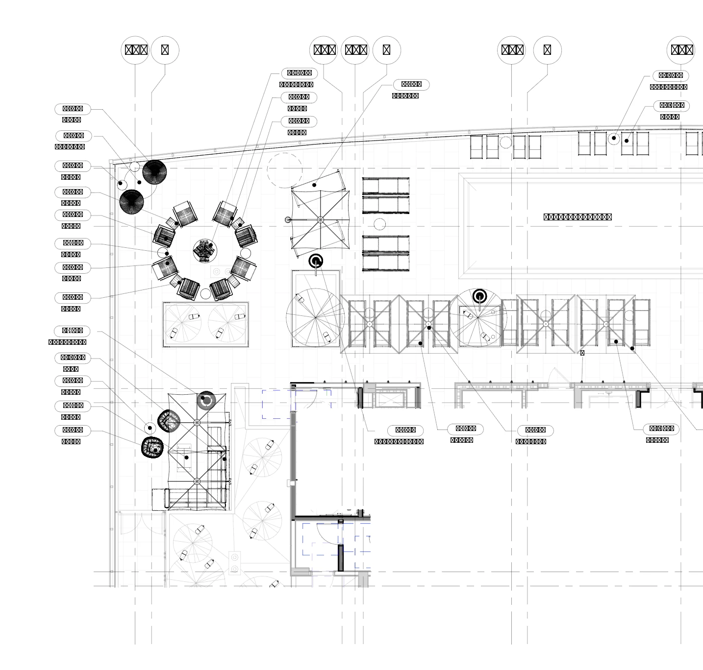

DOV,   On this topic can you please help me with a long time problem that has plagued my usage of AI for years.
As a designer i often will receive pdf's from Architectural firms that invariably will NOT translate the font into anything but boxes with X in them.  I've never figured out how to find the font, however, with a huge job just landed today, i'd rather spend the day trying to finally understand and resolve.   The Font property described in the pdf received describes 3 fonts... Arial, Arial Bold, and Century Gothic.  All three types are Truetype.   When i open them in Illustrator those particular 3 fonts that i have in the library are all described as Opentype.... see attached snaps.  Seems like you might have an instant solution for me perhaps... At least i am praying right now, lol
