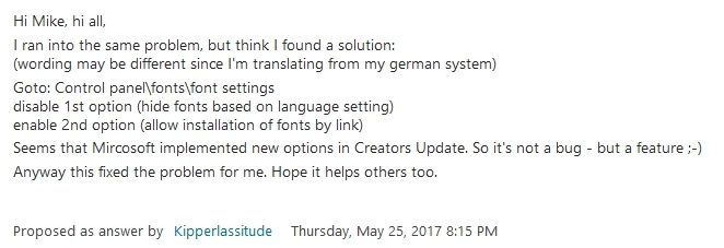

Don't know if you've solved the problem elsewhere yet, but I just got this from the Microsoft Technet Forum and it seems to have worked for me in Photoshop CC 2017:
Hope it helps.
Cheers.
Jun 6, 2017 5:22 PM UTC
Sorry, but I had already tried this and it was no help.
