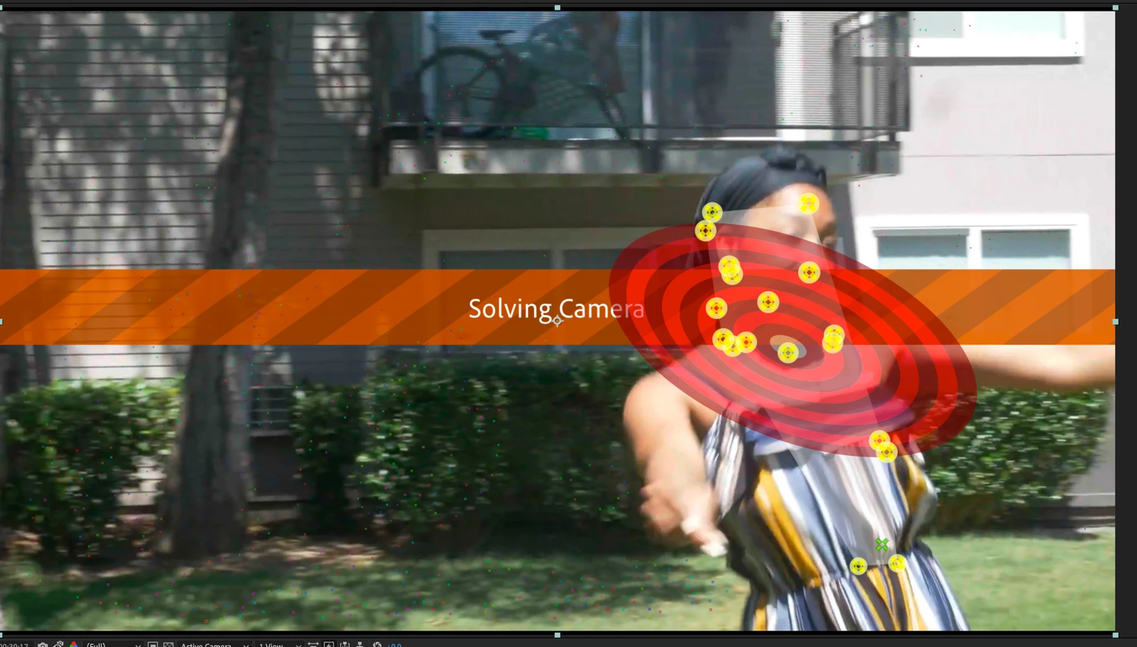

Hello all. I am new to working with after effects and trying to learn tracking effects. So I have an idea which may be ambitious. But I am trying to create a scene where as I rotate around this person, words pop up in 3d space. But they stay there as the camera continues to pan. What would really be ambitious is to do this and then at the end of the scene, back all the way out and see the person with all the words in the space in a wide shot. however it seems like the tracker is having issues tracking the orbiting shot. I'm hoping to get some advice and help with this concept. Thank you.
i attached a youtube clip which is serving as a test clip to practice the effect. and a screenshot of the error message I am running into.

No dice. The camera is too close in, the surroundings don't consistently offer enough tracking features and the motion of the lady of course will massively throw off the tracker, too. this is beyond AE's 3D tracker. If at all it would require working in an advanced dedicated tracking tool like SynthEyes to place manual markers and reconstruct the 3D scene in full, but even there it may not be a walk in the park as you might need to mask out the dancing stuff so it's ignored by the actual tracking algorithms.

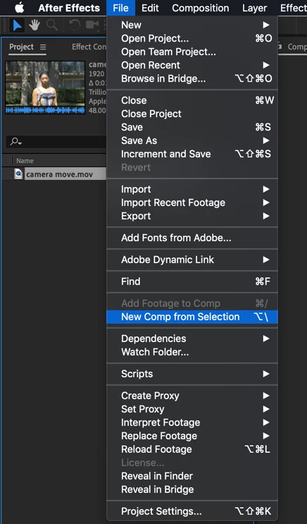

After Trimming the shot in the Footage Pannel by double-clicking the footage in the Project Panel and setting in and out points create your master comp by using the file menu:
This will give you a composition that matches your video's specifications. I took the liberty of creating a Pro-Rez copy of your footage and I'm going to give the project a try for at least one shot and show you the steps. I'm doing something like this for an advanced After Effects training course using my own footage, but I'll substitute yours and show you the steps.

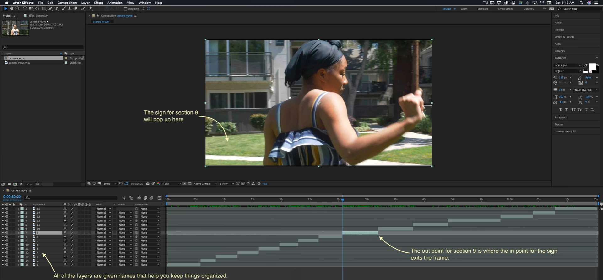

Now you have a comp that contains the final show without effects. The next step is to scrub through the video and decide where the first sign is going to pop up and then figure out where it will go out of frame. You split the layer at every in and out point for every sign you want to pop up in the video. If one sign is going to overlap another you have to create a separate cut. Some of the sections may overlap. You can use the Keyboard shortcut Shift + Ctrl/Cmnd + D to split the layers and then drag the in and out points as needed for the overlaps. You'll end up with a master comp that looks something like this:
If you want the sign in section 10 to pop up before section 9 ends so there are two signs in the final shot at the same time you have to overlap the in and out points like this:

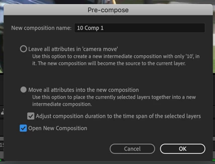

When you have all of the sections edited you pre-compose each layer making sure that you select Move all attributes, Adjust duration and Open New Comp so you'll be ready to move on to motion tracking:

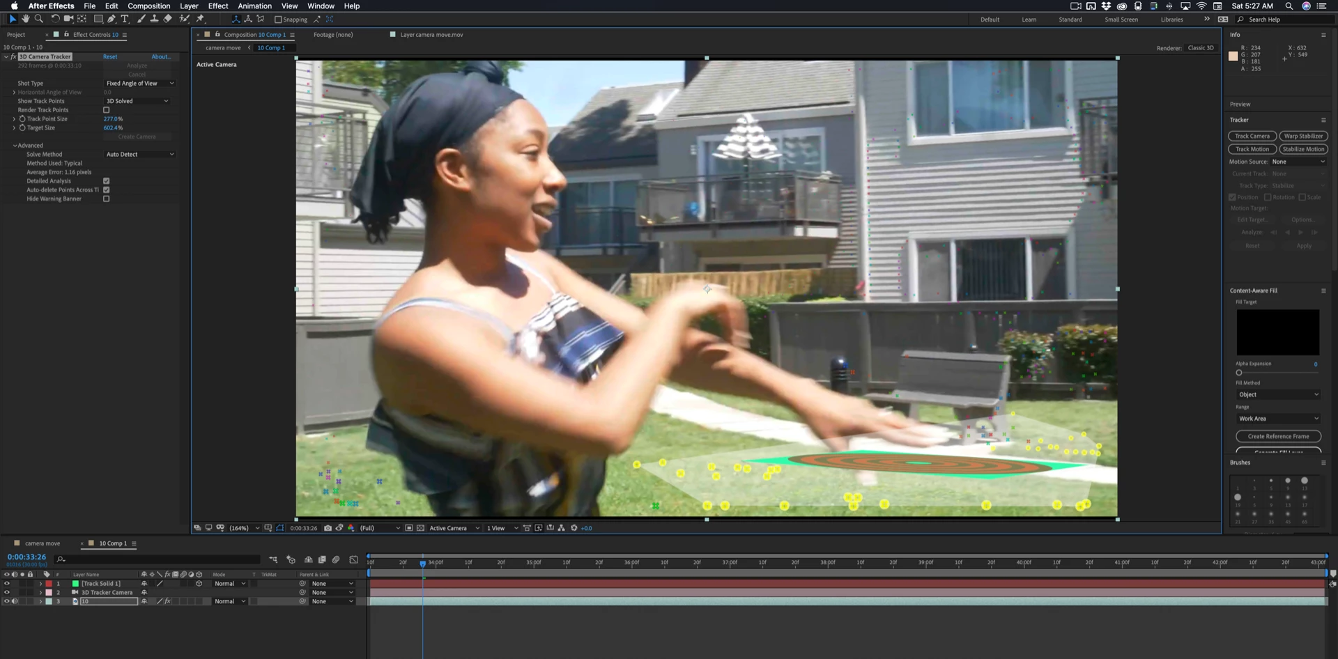

I got a successful camera track first time on section 10:

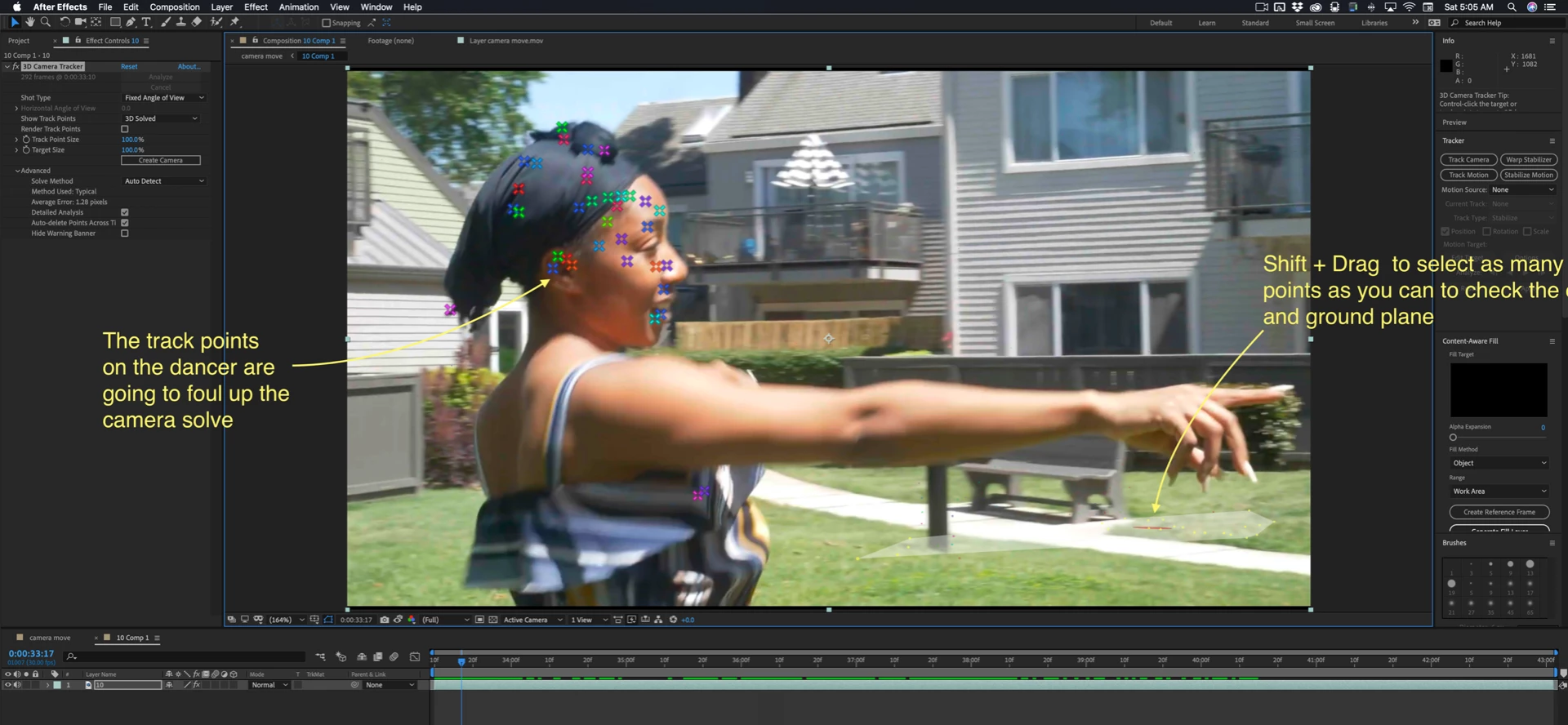

I found a point where I could shift select the tiny tracker points on the ground and get something that looked like a good origin and ground plane for the camera but there are a lot of track points on the dancer that has to be removed. If you have Auto Delete Points across time selected this is going to be easier but you have to go through the shot a few frames at a time and get rid of as many of the track points on the dancer as you can.
Select them by dragging around them then delete. The camera solve will restart after each set of track points is removed.

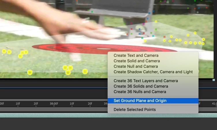

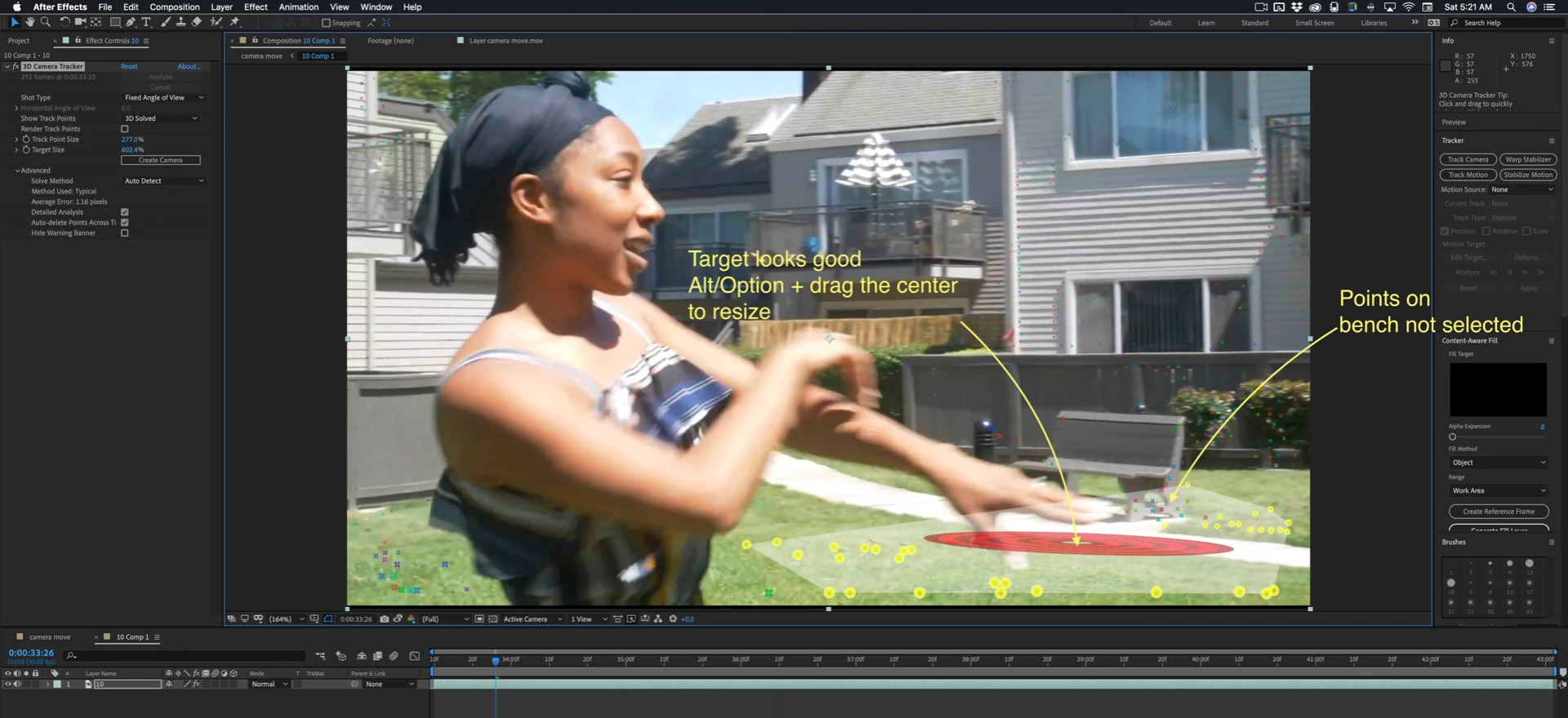

The next step is critical. You must establish an origin and ground plane,  add a camera and a reference solid before you attempt to place your first sign. Sometimes it helps to increase the size of the track points, but the procedure is to select as many points as you need to select on the ground plane, then move the Target into position and size it up using the keyboard shortcut Alt/Option + drag so you can set an origin and ground plane.
When the target looks right, set the Ground Plane and Origin:

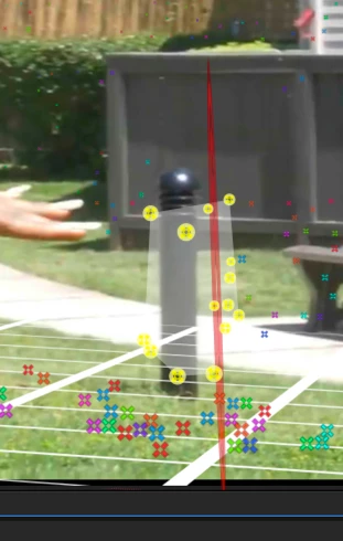

The next step is to figure out where you want the sign to pop up. I want to use this post and replace it but there are no tracker points that give me a good target:

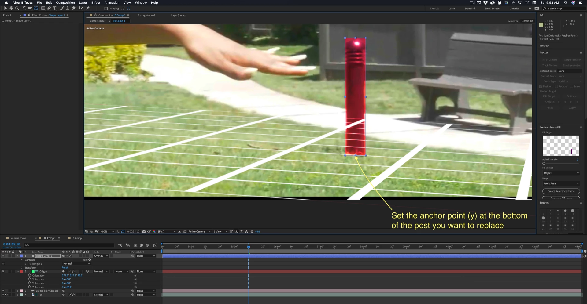

The solution is to create a new shape layer using the Rectangle tool and draw a rectangle that is about the same size and shape as the post. We're going to edit that layer. Select the Rectangle tool and drag a new shape around the post. Set the anchor point at the base of the post, then to make things easier later set the blend mode to something like Overlay. You'll get something like this:

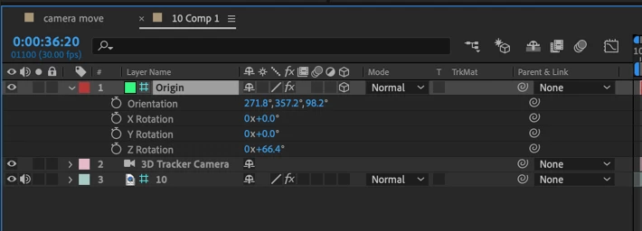

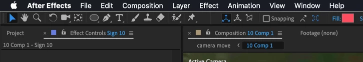

Here comes the fun part. Make the shape layer 3D, name it Sign 10, and hold down the Shift key and parent the layer to the Origin layer. When you make it 3D it will probably disappear, when you hold down the shift key and parent it to the Origin layer it will be moved to the same position rotation and orientation. It's going to look a lot smaller, but we'll fix that.

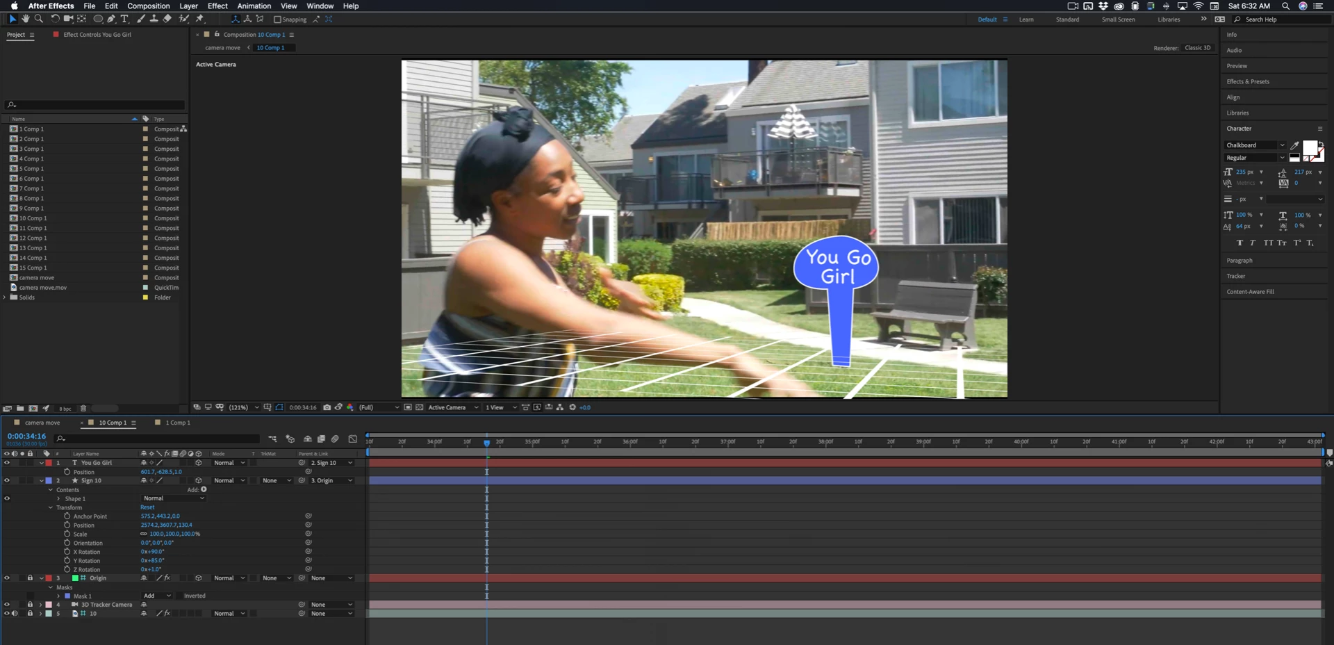

I have just drawn a simple shape with the pen tool, added a text layer, made it 3D, Shift + parent to the sign, then adjusted the position and rotation so that it is properly aligned and the Z position is 1 pixel in front of the sign layer. You should also notice that I have locked the footage, camera, and origin layers to prevent them from being accidentally moved.
Ok, sign 10 is complete. Just repeat the same procedure for all of the signs you want to include in the shot.
