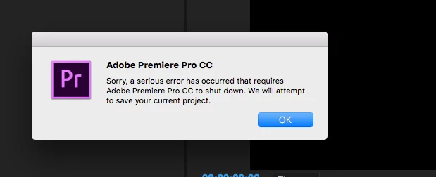

When I double click on a clip in the timeline, I get the spinning rainbow wheel of death EVERY TIME and then I have no choice but to force quit and I will include here a screenshot of the message I get every time after I am forced to force quit:
I tried restarting my computer. I tried uninstalling and re-installing Premiere. And NOTHING WORKS. The same problem persists.
