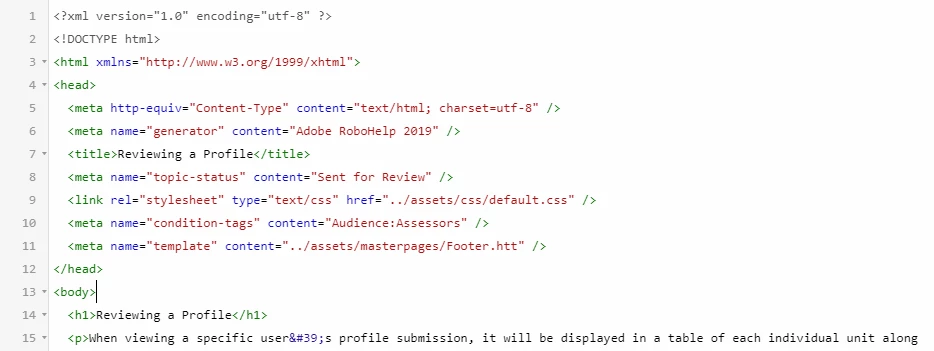

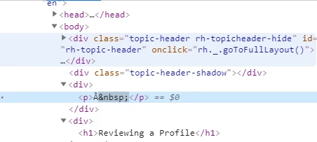

When I export my project from Robohelp to HTML5, it seems to be inserting either paragraphs with non-breaking spaces in them, or with this character as well: Â
The blank divs happen at the top of every page, only some of them contain that extra character above. I'm using the Azure skin with some minor CSS changes.

I have reported to Adobe that you have the space above issue with the  character in it. The hotfix should have solved the problem but they are now aware.

I've installed the hotfix and it has not solved the problem. My project still contains paragraphs being generated at the top of each page containing non-breaking spaces or the Â character above.
New projects do not seem to have this issue, although it hasn't always been present in this project so I'm not sure what could be causing it.
