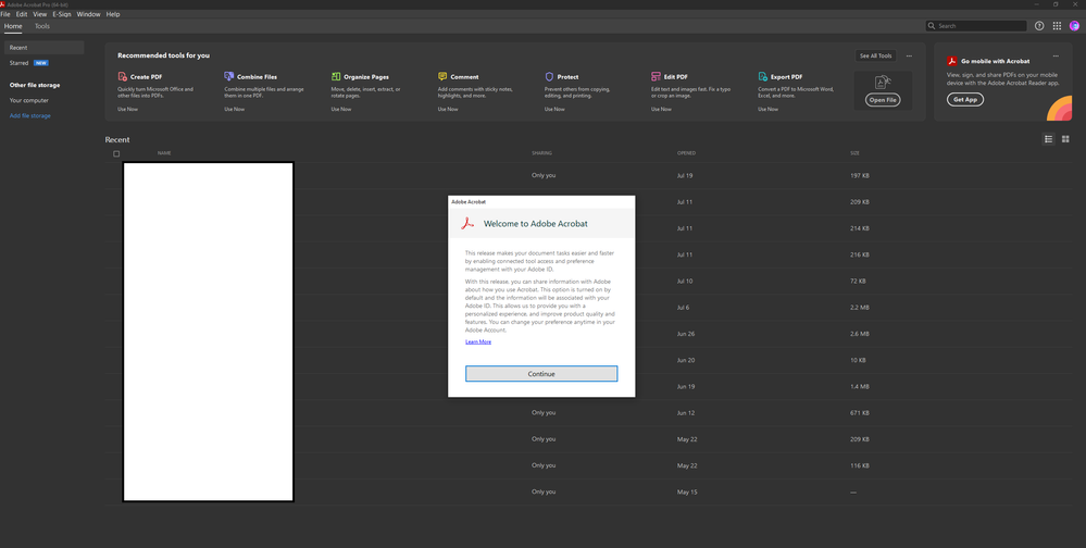

New Here ,
Jul 26, 2023 Jul 26, 2023
Hi Amal. I am experiencing the same. Here are some screenshots of the dialogue and then the grey window which just freezes the whole thing.post notification.PNGnotification.PNG
