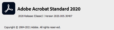

Community Beginner ,
Sep 30, 2021 Sep 30, 2021
Is there another fix to this problem. I have identical symtoms but the June patch will not complete (see below) and the symptoms remains. Adobe and Office 365 apps were reinstalled w/ no joy. The problem began recently under Win10, persists under Win 11. (Office 365 32 bit installed. Q: Will Acrobat work with Office 365 64 bit?)
