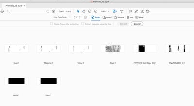

I was wondering if it's possible to extract a page from a pdf and keep the name of the page?
As you can see, below each page I have a name for the color. When I extract the page, acrobat safe them with the pdf file name and add a different number at the end.
 Ideally, I would like the first page to be named  Cyan:1, the second page Magenta:1, and so on just like in the pdf file. Any idea how to do so?

This can be achieved using a script, but not with the built-in Extract Pages command.

Depends on how you want it to work, but it will need to read the page's label first (using getPageLabel) and then extract that page (using extractPages), using that name as the file-name of the new file.

I want the main PDF file to be safe into multiple PDF with each having the name they add originally in their page label.
I work in the printing industry and those PDF are the color separation of a job, so let's say I have a 4 colors job, the label is in the main PDF file Cyan:1, Magenta:1, Yellow:1, and Black:1. Right now when I extract the pages all the files have the same name but with a different number and that's not what I want. I want to have four different PDF with one named Cyan:1, the other Magenta:1, and so on.

For the first 4 (CMYK) you could even use a small OS script, renaming the first page to Cyan etc. But as the other plates can convey any spot colour or even "vernis", that part can only be automated if you have always the same colours (in the case of a customer having hundreds of files like this). If you want to have a universal solution, you need to hire @try67.
Before that, however, I suggest you look at this: https://community.adobe.com/t5/acrobat-sdk-discussions/js-to-extract-multiple-pages-and-name-as-page...
