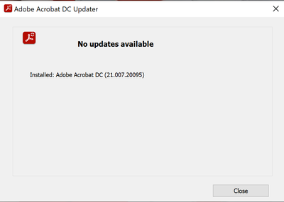

I agree - changing the way it's displays the colors (intended for accessibility help) is not a fix - just a way of putting a band-aid on a gaping wound.  Adobe is aware of the issue, as I have seen a comment on one of these threads regarding this issue.  But it's now been weeks - and this has to be fixed!  C'mon!  There was an update posted about a week ago.  I can'tg verify if it's fixed, since I never saw the yellow stuff reported by many others.

I removed the software and downloaded the newest version of Acrobat and the issue was still there, so it was not corrected in the latest update.
