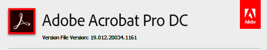

May 19, 2019 May 19, 2019
I am having this same problem.. been trying to work on it for 30 minutes.  yes, our product is up to date and I'm using Adobe Acrobat Pro DC - I obviously was able to at one time because I have images on the document from previous versions.  Now I keep getting this message, after trying to copy and past into my pdf that the image cannot be converted to a pdf.  Why should it need to be?
Very frustrating
Adobe Employee ,
May 20, 2019 May 20, 2019
Hi Tylert,
Sorry to hear about the frustrating experience.
Would you please share the screenshot of the exact version of Acrobat you are working on? Open Acrobat>Help>About Acrobat DC.
You can paste the screenshot following the instruction given here: https://forums.adobe.com/docs/DOC-7043#jive_content_id_How_do_I_attach_a_screenshot
Akanchha
Community Beginner ,
May 24, 2019 May 24, 2019
