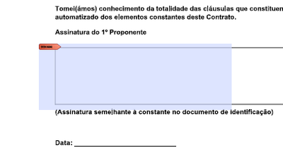

Hi, i am also having the same issue. Unable to see signtures in Acrobat that are otherwise visible in browser. The print as Adobe PDF did work, but i've got hundreds of signed contracts and forms that I'd have to convert, as they are all automatically downloaded froom the signature portal as pdfs. Any other fixes? I've dissabled security view, checked the fonts, and all other suggestions, but the signed signature boxes appear blank when opening in acrobat no matter what I do.

This issue arises when a user applies an e-signature to a digital signature (DigSig) field. The DigSig field expects a certificate-based signature (a signature with both a signature dictionary and appearance dictionary for visible signatures). However, an e-signature, or appearance-based signature, doesn’t utilize the signature dictionary— it only creates a visual appearance. Therefore, if an e-signature is applied to a DigSig field, it results in only a visual representation without the necessary signature dictionary.
Other PDF viewers, like Chrome or Preview, lack the ability to validate a digital signature and rely solely on the appearance. As a result, they display the signature appearance regardless. Adobe Acrobat, on the other hand, requires a certificate-based signing process for DigSig fields. If this isn’t done, For complying with security of signature standard Acrobat ignores the appearance entirely.
When users choose to “Print to PDF,” the interactive DigSig field is flattened and removed, so it no longer functions as a DigSig field. Consequently, Acrobat displays the appearance in this flattened format, similar to how other viewers handle it.
