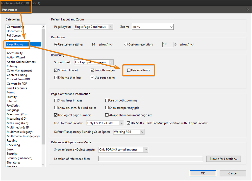

This is because these fonts are not embedded in the document.
Acrobat does not use system fonts to display documents unless explicitly instructed.
You must enable this option to see documents correctly displayed:
New Here ,
Nov 28, 2021 Nov 28, 2021
Hi, this box was ticked, so this wasn't the issue.

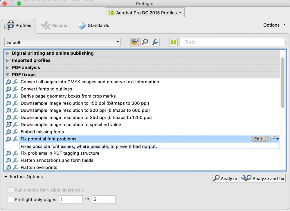

Have you tried embedding the fonts using a preflight fixup?
Tools> Print Production> Preflight> PDF fixups. If your PDF is still not displaying correctly, it's possible the needed font is not on your system and cannot be embedded. To check your PDF fonts, go to File> Properties> Fonts, all should say embedded or embedded subset.

New Here ,
Nov 30, 2021 Nov 30, 2021
If I open that section of PDF fixup, it looks exactly the same as the image that you've shared. What do I need to change to correct the issue that I'm experiencing.
When I run the preflight on my Mac, the fonts in your PDF are properly embedded. I believe ArialMT is a Microsoft font, it's probably not working for you because ArialMT is not on your computer.
You could try the preflight shown on this screen shot, however, you will likely get the same error.
FYI, if the preflight did work, you could add it to an Acrobat action which would allow you to easily apply it to a PDF or a folder of PDFs. You don't need to apply it to every PDF, only the PDFs that have unembedded fonts.
Is your Acrobat fully updated? Do you have MS Office installed?
