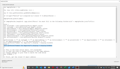

JR,
Thank you for the code. I am getting an error while trying to add the script. The line in red below is what is highlighted in the screenshot. As I learn more and more, I realize there is so much more to learn.
I am guessing the curly brace on line 13 opens the validation of required fields, then another on line 24 opens whether the button will appear or not, with another open curly brace on 26, and closed on line 28 if there is a required field not filled in to continue hiding the button, and then the whole part of this script closing at the end on line 46, but I am not sure why there is another closing curly brace on line 47. I am not sure if this makes sense ( I did try to figure it out before reaching out again) and I may just be talking out of my Ass-cot, so please bear with me.
else {
var firstname = this.getField("First Name").value;
var lastname = this.getField("Last Name").value;
var emailaddress = this.getField("Email Address").value;
var divisionemail = this.getField("Division").value;
var projectcode = this.getField("Project Code").value;
var departuredate = this.getField("Departure Date").value;
var returndate = this.getField("Return Date").value;
var departureairport = this.getField("Departure Airport").value;
var arrivalairport = this.getField("Arrival Airport").value;
if(firstname != "" && lastname != "" && emailaddress != "" && divisionemail != "" && projectcode != "" && departuredate != "" && returndate != "" && departureairport != "" && arrivalairport != ""){
this.getField("Submit for Approval").display = display.visible;
else {
this.getField("Submit for Approval").display = display.hidden;

@ls_rbls, thank you for the input. I was still getting syntax errors so its in another part of the script
Copy link to clipboard
Copied
Sorry, I added orange lines without checking the rest of your script, some curly braces were missing.
This one should works:
