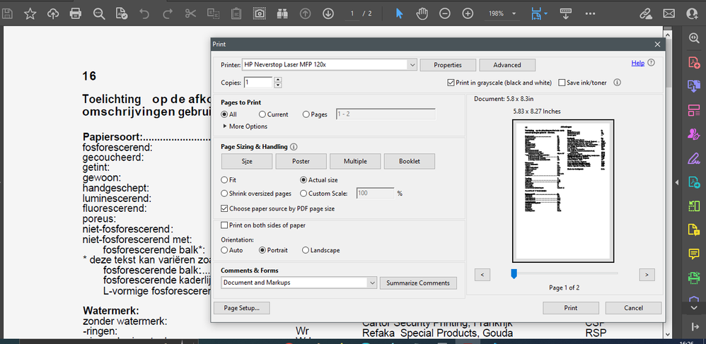

Just for good order's sake, this is the idea. On the left you see pages being purple
Then "Tools" > "Print Production" > "Output Preview", uncheck colours only leaving "Process Black" checked.
Result is on the right.
Now it looks fine, but as said, the next step is, how to save the document like that, or print as a new document,
or how to achieve the same in Print > Advanced?
Thanks.
p.s. note that I am not familiar with things like 'preflight profile' - I add above and below screenshot, so as to avoid misunderstandings on what I am trying to achieve.

@adwul62  and @Luke Jennings3 @Amal. ,
++UPDATE,
The shared file was already OCR'ed. so I was able to employ the Edit PDF with  Print Production => Preflight => Edit Object
After that you just need to Print the file normally without the need to mess around with the Print Properties.
See slides:
EXAMPLE OF USING THE EDIT PDF TOOL AFTER AN IMAGE WAS OCR'ed:
RESULT OF DOCUMENT WITHOUT IMAGE BACKGROUND SHOWN BEHIND THE PRINT DIALOG WINDOW:

The supplied test pdf contains an RGB purple background with some scanned text images (the dots), the pdf also has OCR type in gray. My attempts to preflight out the purple resulted in removing everything (included the wanted dots), or just the purple created from the scan around the type. I want to fiddle with it more when I have time, as this should work with the right settings. I have attached the two converted pdfs. Note, the OCR is inconsistent (the dot spacing) so the scans should be re-done or the copy re-set, if this is important.
