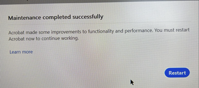

Message- "Maintenance Completed Successfully" appears everytime opening PDF
New Here ,
Nov 16, 2023 Nov 16, 2023
HELP ME PLEASE !!!
I am running:
Adobe Acrobat Pro (23.006.20380)
Windows 10 Pro / 64-bit, x64-based
Each and every time I open a PDF, I receive the following message:
"Maintenance completed successfully
Acrobat made some improvements to functionality and performance.  You must restart Acrobat now to continue working.
Learn More       Restart"
I have tried everything I know to do to stop this, but nothing works.  This is interfering greatly with me doing my job.
