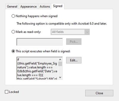

In my form I have a signature field and a date field with a submit button below it. My goal is when either both or one of these fields are empty the submit button is grey and read only. It becomes enabled only after both fields are entered. My script works beautifully with the signature field, but the date field doesn't seem to effect the button regardless.
Here is my script:
if ((this.getField("Employee_Signature").value.length === 0)&&(this.getField("Date").value.length === 0)){
this.getField("Submit").fillColor = ["RGB", 192/255, 192/255, 192/255];
this.getField("Submit").readonly = true;
} else {
this.getField("Submit").fillColor = ["RGB", 0/255, 170/255, 0/255];
this.getField("Submit").readonly = false;
I have this script running in both the signature field and the date field. Here is the location of the signature field script:
and here is where I have it for the date field:
 My script doesn't appear to have any errors, I've tested it, but is it missing something? Or am I putting the script in the wrong place?

In the latter, change this line:
To:
event.value

Dec 10, 2020 Dec 10, 2020
Copy link to clipboard
Copied
Get rid of the signature field and use the following as the custom calculation script of the Date field:
if (this.getField("Employee_Signature").value.length == 0 && event.value.length == 0){
} else {
If you see it's not "kicking in" add this line to the top of the script, and then remove it after it has executed:
app.alert(event.value.length);
Copied
Remove the script from the signature field. Use the one I provided as the calculation script of the date field.
Votes
Explorer ,
Dec 11, 2020 Dec 11, 2020
Copied
Thank you for all your help. It turns out the script was still missing something. I believe it was still only reading that as long as one of the two fields had a value greater than 0 then it was ok to enable the button, but both fields needed to be greater than zero. This final script is really rough, but it works exactly how I need it to. If someone can rewrite my script to do the same thing but not as messy please do!!!
if (!(this.getField("Employee_Signature").value.length == 0) && !(event.value.length == 0)){
} else {
