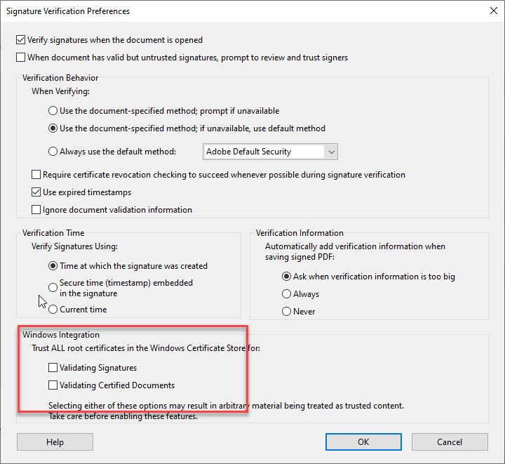

If I uncheck both of the 'Windows Integration' settings in the Signatures>Verifications area, I am able to sign documents.  If I re-select them, I cannot sign documents.
Apr 22, 2021 Apr 22, 2021
You should leave those uncheck anyway. See the disclasimer below those two checkboxes.
You should be cautious with those two options, specially if you're using expired certificates.

Yes....I do understand the disclaimer, but we need these options checked in order to verify our trusted root certificate.
We have always had that setting in place without any issues until this week...after creating a new graphic appearance.  Our certificate is not expired, but we did just renew it.  The issue could be linked to this.  I am not having this issue with other PDF readers...Bluebeam or Kofax Power PDF.
