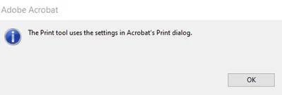

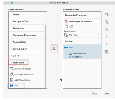

I need a workaround for the "Print" Action limitation which does not allow me to "Specify settings".
Instead, when I click on the "Specify Settings", it says it will default to what my printer is set to:
This is not helpful to me b/c I have over 100+ users who use this action wizard to process their files and I cannot tell them what setting to have. Plus, they would have to do this everytime which would be annoying. It would be great if the action wizard automatically sets the setting (File >Print and then select "Adobe PDF" for the Printers). This is the setting I would want it to resort to when a user uses my action wizard. Is there a work around for this? Note, I need it to save the pdf only in this manner: File >Print and then select "Adobe PDF" for the Printers. Can a javascript be written for this?

What is the purpose of processing PDF files and printing them as PDFs?  Your answer will help me provide a solution.  Instead of Print for the action use Execute JavaScript and then use the following script:
var pp=this.getPrintParams();
pp.printerName="Adobe PDF";
pp.interactive=pp.constants.interactionLevel.silent;
this.print(pp);
Make sure you have the following settings in your Adobe PDF printer:
