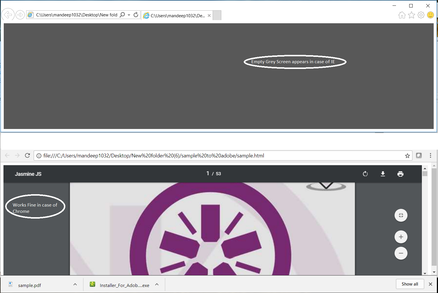

Hi Guys
I am also facing same issue. Grey screen appears in case of Internet Explorer but works fine when tried in Chrome. I am using embedded pdf. Refer attachment for snapshot. (I can share a sample as well if required) Let me know in case some more information is required from my side. Any help on this will be highly appreciated.
I am using Windows 10, IE 11, Adobe Reader 10 & 11

Adobe Employee ,
Jul 18, 2017 Jul 18, 2017
Hi Mandeep,
Do you face the issue only for this PDF? And what about the web PDFs? Does the issue reproduces in that scenario too?
Regards
Soumik
New Here ,
I face issue in case i am using embedded pdfs (Any PDF).
Regards
Mandeep
New Here ,
I can share a sample for same as well, this might help technical department to better understand & reproduce problem at there end. You can share an email where i can post sample project.
Regards
Mandeep
Adobe Employee ,
Please send us the files at soudas@adobe.com.
Also share with us the IE and Acrobat/Reader version.
Regards
Soumik
New Here ,
Mail Sent @soudas@adobe.com.
Please let me know in case some additional information is required from my side.
Regards
Mandeep
