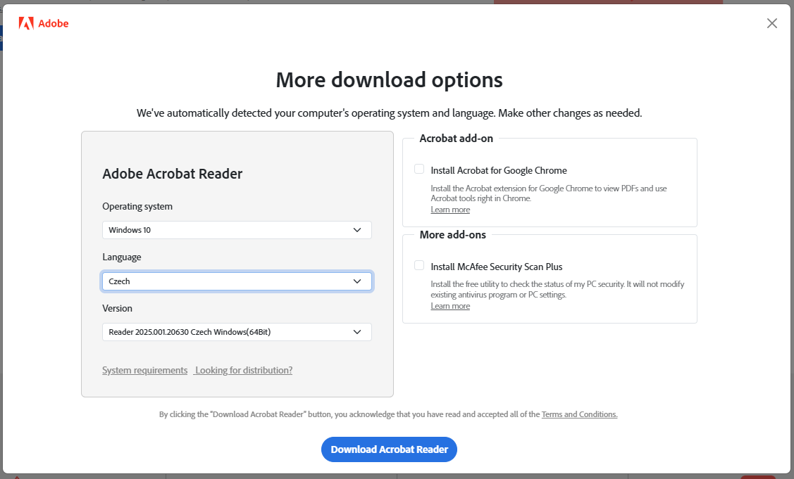

Thank you for your reply. However, your advice did not help. I uninstalled Adobe Reader, then used AcroCleaner, downloaded a new 64-bit installation, but when I run it, the 32-bit version is installed...
Unfortunately, I cannot provide the PDF, as it is a contract containing sensitive information. The problem only occurs with some PDFs. They display incorrectly on multiple computers. However, it works fine in the 64-bit version (on Windows 10 and 11).
Attached:
1) This is Windows 10 64-bit
2) The 64-bit installer is downloaded
3) The 32-bit version is installed
