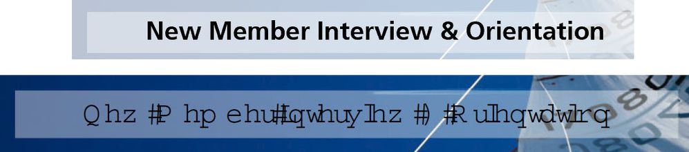

Hi, I have about 50% of our users that when they save from powerpoint to PDF the font distorts. They all have Win10, office 2016 and latest version of Adobe reader. I have tried uninstalling Office, Adobe, checked/played with save settings in Powerpoint and Adobe especially the embed fonts but I cannot fix. Microsoft print-to-PDF fixes the font issue but creates other formatting issues.
Screenshot of example below, you can see where some of the letters are touching each other. Any ideas?

New Here ,
Jul 10, 2019 Jul 10, 2019
Ok, so no replies to a thread I started over at Microsoft.
So purchased Adobe Standard DC for one our users, and still getting exactly the same issue, just can't work out what is going on.
This after conversion
How it looks in powerpoint.
From Document Properties
Embed all fonts was selected as Amal above suggested. Have tried High Quality conversion, exactly the same.I even emailed the PPTX to myself and converted fine on my PC (I only have reader)
Again any ideas?

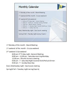

I have a similar issue. I have Adobe Acrobat DC (licensed version, latest updates) and the PDFMaker add-in for PowerPoint 2016. I can use the Create PDF button to print slides but it does not allow you to print Speakers Notes. Ok, I can get around that, I'll just use File > Print > Adobe PDF and print it out that way. Nope! The fonts that printed out so clearly, crisply, and professionally using the Create PDF button on the Acrobat ribbon in PowerPoint, WON'T print in the Speakers Notes slides. It comes out as "garbage", as if the font I used didn't exist on the computer.
Check this out - The top one is from the slides as printed via Create PDF; the bottom one is what I get when I use File > Print > Adobe PDF. (Side note: notice how much darker the colors are? I have no idea how to fix that either.)
The font is properly installed and I've used this same font in other Adobe products (Illustrator). Why on earth would I get two different results? Also, why can't I PDF a proper set of Speaker's Notes?

That was one of the first things I tried and it is a meaningless option because it does not actually produce "Speaker Notes" with the slide above the text. Instead, it converts the notes into a comment/annotation icon in the upper left-hand corner of the page which none of my users can use because they only have Reader (and it doesn't seem to work on tablets). This is what you see at the top of the slide:
Here is a side-by-side comparison between a printed Speaker Notes page (File > Print > Canon Inkjet) vs the File > Print >Adobe PDF version and you can see that 1) the font is garbled on the slide and it is twice as dark as it should be. I can live with the darkness, I cannot live with the text being garbled.
