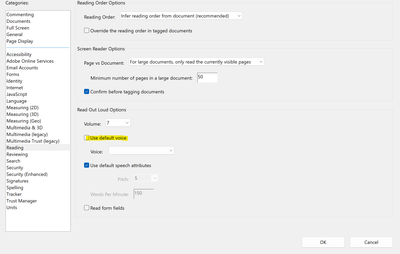

Changing to Zira - Security enhancements still enabled worked.
David's voice does not work
New Here ,
Aug 18, 2020 Aug 18, 2020
Removing the default voice and choosing Zira's voice worked for me. Disabling/Enabling security did not have any effect. Thanks.

I am having similar problem with my read out loud. It looks like I do not have any voice set up in my Adobe Acrobat DC 32bit.
Do you know how to add default voice?
