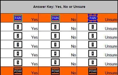

I have a form that contains 25 rows of questions with associated groups of checkboxes to answer by the recipients. I need to make it a requirement so that ONE of the checkboxes are marked for each of the questions before they can submit the form.
See my screen shot below:
For example, in the first orange row all 3 checkboxes are titled "PAIN" with export values of: "YES", "NO", and "UNSURE".
On the second row, all 3 checkboxes are titled, "1" with export values of: "YES", "NO", and "UNSURE".
Third row and on just keep going in the same manner. Each row share the same title and have the export values as mentioned above.
Is there a script I can use so that the recipients are required to select 1 checkbox from each group/row before they will be allowed to submit their form?

Okay,
So I replaced my "SUBMIT Form" action with your script above and it's definitely showing a pop-up window when I try to submit the form indicating the fields marked as "required" haven't been completed.
But it's not including any of the checkbox groups in the rows/columns in bottom half of my form.
Do I need to do something to the checkboxes to so that they're included in this requirement? Should I mark all of them as required? The reason I ask is because I thought that if I marked all the checkboxes as "required", then wouldn't it require the recipient to select them all before submitting the form?
Sorry if these are dumb, obvious questions - I'm still learning here.
I've saved a screenshot below of what I"m getting: As you can see, I didn't check any of the checkboxes, and when I hit SUBMIT, the only fields it is still requiring me to answer are the text fields at the top of the form.
Hi try67
Never mind on my last question - I didn't realize I needed to mark all the checkboxes are "required" (thought it would produce a different outcome).
Everything works perfectly!
