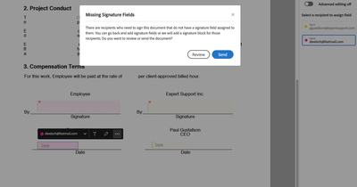

After uploading a pdf to Adobe Sign in Acrobat DC Pro, and specifying the recipients, then the corresponding signature and date fields, then pressing send; an alert appears that says that there are missing signature fields with the option to review or send.
  • Have properly set signature and date fields to signer's email in sidebar.
  • "Review" shows that everything looks fine.
  • "Send" generates an agreement with duplicate fields added further down on the page from the ones I've created.

If there are more than one signers in your agreement, all signers should have a signature field assigned to them. If that is not done, Adobe Sign will notify you with this warning dialog and add signature fields by itself for all the signers.

Hi Sameer, there are only 2 signers and both signature and date fields were set. There is no need for additional fields to be set automatically. Adobe Sign doesn't seem to be recognizing that the fields have been set, so it adds them again.
Any other ideas?
Sure seems like a bug to me.

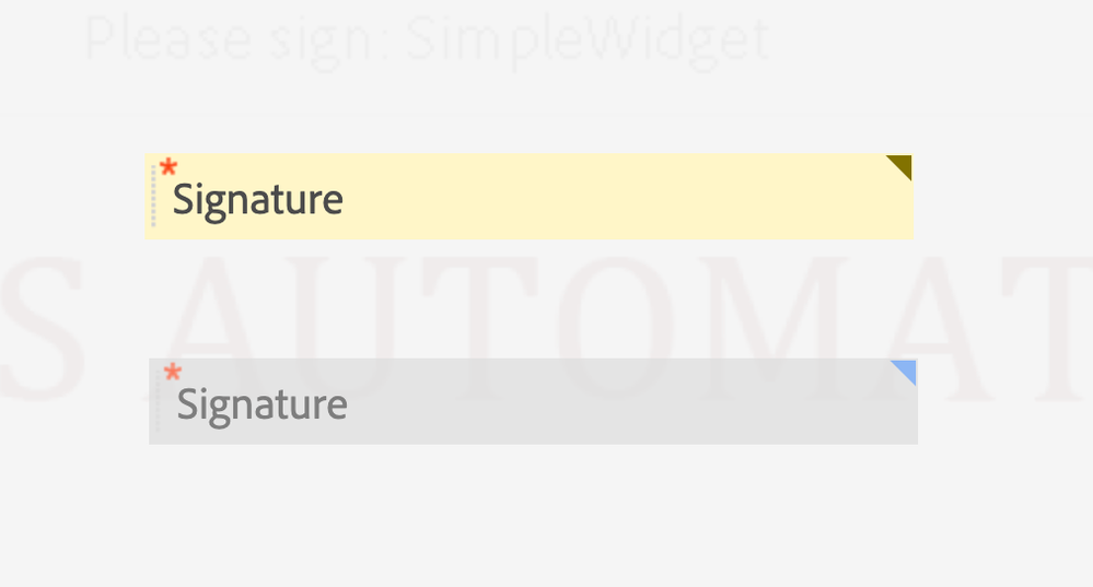

Even if you add 2 signature fields, both the fields need to be assigned to different signers. You can do that by double clicking on the Signature field and changing the 'Assigned to' value.
The colored ribbon on the top right will be different to confirm that both fields were assigned to different signers. It should look something like this:
If you have done this the right way, and still facing issues, please attach a screenshot of the actual document which you are trying to author to help me understand the issue better (It is kinda difficult to debug it remotely though 🙂 )

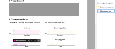

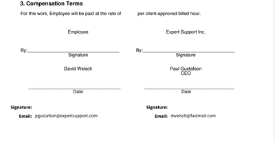

  • Here are some screenshots that illustrate how the fields I set are being ignored and Adobe Sign is adding new ones.
  • Some of the legal content has been intentionally obscured, there are no text issues.
Thanks for trying to help!
Keira 🙂
Adobe Employee ,
Sep 23, 2021 Sep 23, 2021
Those signature fields don't look like signature fields to me, but rather like required text fields.
Signature field should have a hint in the field just like the date field has 'date' in it.
