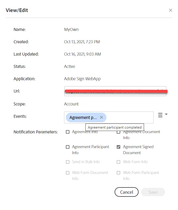

Web hook doesn't send Signed agreement document attributes in the response
We have configured a web hook with Event "Agreement Action Completed" and selected "Include Signed Agreement" Notification parameters. However the attachment stream of signed agreement is not being sent as part of the response.

it should include the signed pdf as base 64, though I advise against grabbing the signed pdf from the webhook and only use the this webhook event to make a call to
get /agreements/{agreementId}/combinedDocument
a few reason for this, one there's a non-zero change te signed pdf is not included in the payload if the webhook payoad exceeds 10MB.
The signed PDF is also goverend by some settings in the Sign account. There's a setting to keep documents seperate. If that is selected, the signed pdf in the webhook only includes the first uploaded document.
So by using API call instead you'll have more control on exactly what get's downloaded.
