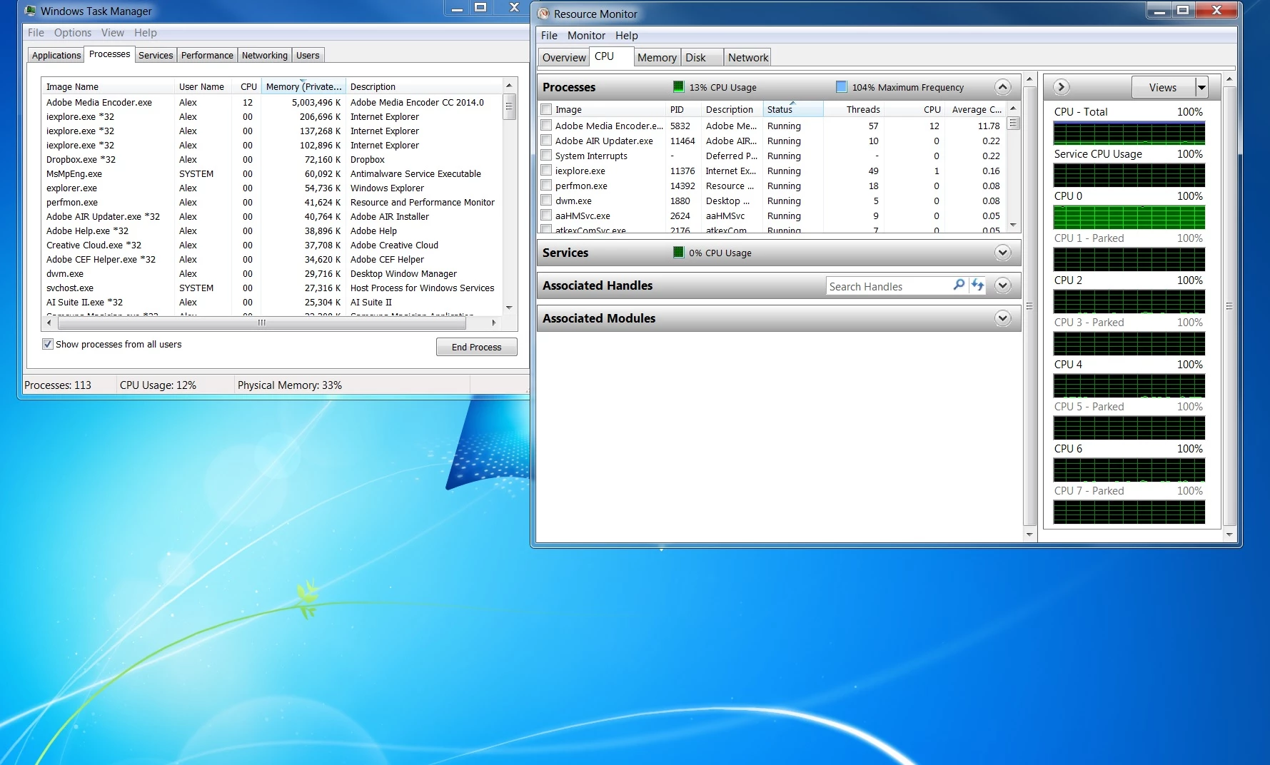

Encoding is very slow with AME CC 2014. Resource monitor shows only one of the eight CPUs working while the rest are parked. This was not happening in CC version. Is there anything I can do to control this? I happen to be exporting to h264 Bluray. Says it has 2 1/2 hours remaining, which is way tool long for this project.
Correct answer MMeguro
Software-Only rendering made it much slower. Disabling 'Import Sequences Natively' did not make a difference
Thank you for trying Alex.
I stumble upon this article regarding the CPU parking performance issue.
http://ultimatecomputers.net/forum/viewtopic.php?f=7&t=3644
This article also tells how to fix the CPU park issue.  I wonder if this can solve your issue.  It may be worth trying.  This involves the registry change.  So, please make the change very carefully if you have decided to follow the fix instruction.

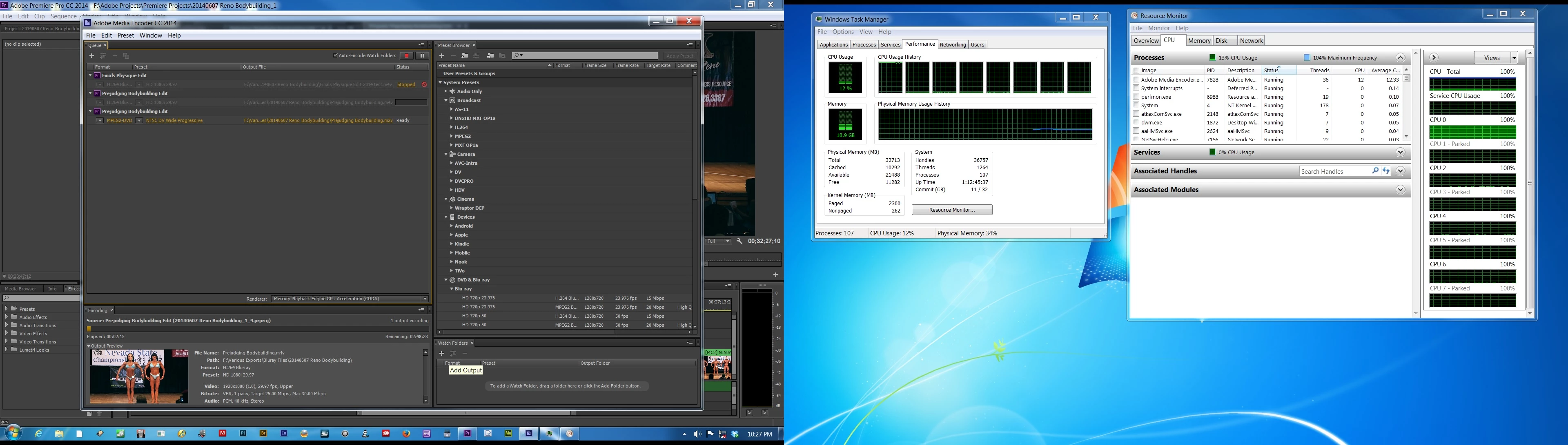

westley
December 17, 2014
23min video timeline queued into Media Encoder 2014.1 Build 8.1.0.122 using a H264 1 pass VBR 20-25mbps preset. CPU parking disabled as per the post above with the registry edit.
  • Import sequences natively enabled, total encode time 1hour and 36 minutes
  • Import sequences natively disabled, total encode time 21 minutes
This 21 minute encoding time is the type of performance I was accustom to with CS5.5
When I get time I will update to the the 2014.2 build which was released today and see if native sequences work in 2014.2 but until then I have a few more projects on a deadline so update with have to wait as little while.
westley
December 17, 2014
Very bizarre I had the CPU parking issue with AME. I then applied the regedit to stop the CPU's parking and it worked perfectly on a recent project for 25min video that took about 25 mins to render with H264 1 pass 20-25mbps so all good. Just as I got with AME CS5.5
However today I go to render out a 23min video and bam it takes 1 hour and 10 mins. Using the exact same preset and checked that the regedit was still present in my registry. I just don't get it. I am very confused. Also don't understand why I never had this issue in AME CS5.5 and now have this issue with CC2014.
Seriously Adobe I love your software but this is a show stopper and is now getting in the way of productivity. Please please please Adobe or someone else shed a little light on the issue.
I will try switching off native sequence support and also try without cuda support and software only and report back if it makes any difference.
i7 980 Gulfton 6 core @ 4.1GHz
24GB Ram, 4x Samsung SSD
