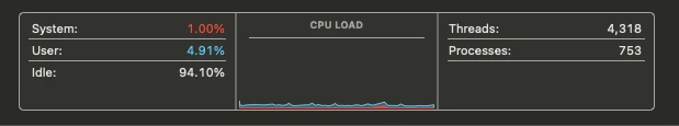

Once I start to export in ME, it will do 50% and then stop.  And it will stop for HOURS.  Like 6-10+ hours.  Just sit there.  No real CPU activity, nothing.  Then it will randomly fire up and finish the project.

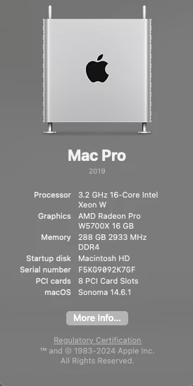

#3 camera edited sequence, color correction, Beauty Box filter, and that is about it.  A lower third logo, but nothing really graphics heavy at all throughout the whole project.  This machine should BLAZE through that export, but no.   Even without the pause, it is still taking TWICE as long as the length of playback.  1hr20m podcast, is taking 3 hours on remaining time.  Then add in a 6-10 hour break in there, you can imagine it is bery frustrating.  I mean, there is no CPU acitvity, but could something be processing in the backround on that i am not noticing?  Is this thing actually still "working" behind the scenes?

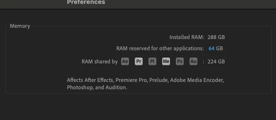

  • Have you tried to reset the Preferences? (If no, do that.)

    Just did.  Will try that.

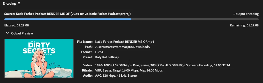

This is a long shot, but i see that you have set the encoding to VBR 2 pass with both Target and Max set to 16. If you want to take advantage of 2 pass you should use different values such as Target 16 and Max 20. My suggestion is to always avoid 2 pass, because it fails too often.
Try to set it to CBR and Target to 16 and test that. (See image below)
If that fails as well, just use a Preset such as the Match source - High bitrate and don´t change anything else.

Thanks for chiming in.  So, it is indeed exporting.  It is not failing.  Just takes a LONG pause during exporting.   It does this BOTH during Media Encoder AND when exported directly from Premiere Pro.
I am currently using those settings i posted about so that social media platforms compress minimal amounts as possible.  But can be prersuaded otherwise if there is a better way?
I tried your method of CBR with target bit rate of 16.   It did NOT hang up at 50%.  Went straught through the export.   (Again let me clarify, when i experince the hang up, it stalls for hours but it DOES finish.)
