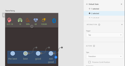

    Hi @Noga Deutsch, I'd suggest making the whole form a component and depending on the radio button clicked, changing the state of the component to "1-selected", "2-selected" etc. And in "1-selected" state as you guess, the first radio button should be selected while others remaining unselected and so on. Hope this helps!
    January 6, 2023
    thank you. I did create 1 selected, 2 selected....
    but... how can I define that only one state can be active... for some reason this is not the behavior I'm experiencing.
    what did I miss? 😞

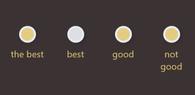

    January 6, 2023
     just created an example.. these are not the actual values... just for the discussion...
    thanks,
    Noga
