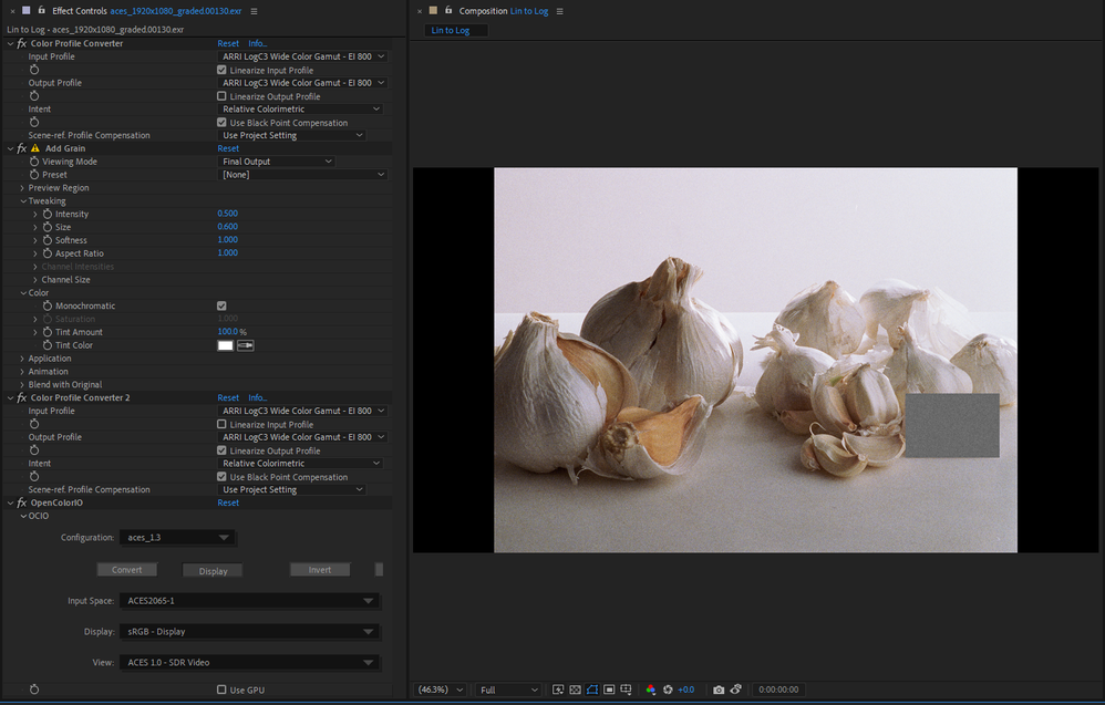

Sep 04, 2022 Sep 04, 2022
It's a lot better to apply grain in log space. While it's true that you can compress and expand values above 1.0 non destructively with HDR Compander the image state in between isn't really useful especially if you have high values. To preserve specular of 16.0 reduces the entire image immensley if the rest of the image sits around 1.0 and below on average. So grain values get applied on incredibily low values but get blown up afterwards by the reverse process making the image look worse and introduce negative values.
Using a Color Profile Converter to go from an arbitrary known linear color space to the same space in log and back is much more robust. For example ARRI LogC/Linear. It doesn't matter what the source image is because we only care about temporarily converting the transfer function from lin to log and back.
That said, it would be nice to have an updated 32bit Add Grain.
In example below I reduce up to 16. The highlight on the big garlic midleft was around 13. HDR Compander produces redicoulus contrasted grain with negative values. Lin to Log behaves as expected.
HDR Compander
Lin to Log
