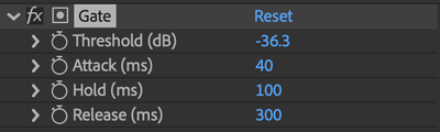

Gate - Your Audio Noise Door
The Gate effect silences audio that falls below a certain volume threshold. It's perfect for cleaning up noisy recordings, removing background hiss, or creating dramatic audio cuts.
Key Parameters:
  • Threshold (dB): Range -60dB to 0dB (default: -60dB). Audio below this level gets muted. Set it just above your background noise level.
  • Attack (ms): Range 0-1000ms (default: 10ms). How quickly the gate opens when audio exceeds the threshold. Fast attack = immediate opening, slow attack = gradual fade-in.
  • Hold (ms): Range 0-2500ms (default: 40ms). How long the gate stays open after audio drops below threshold. Prevents rapid on/off switching.
  • Release (ms): Range 5-4000ms (default: 220ms). How quickly the gate closes once the hold time expires. Fast release = abrupt cutoff, slow release = gentle fade-out.
Tip: Start with the default -60dB threshold and adjust upward until background noise disappears, but be careful not to cut off the natural decay of your main audio.
