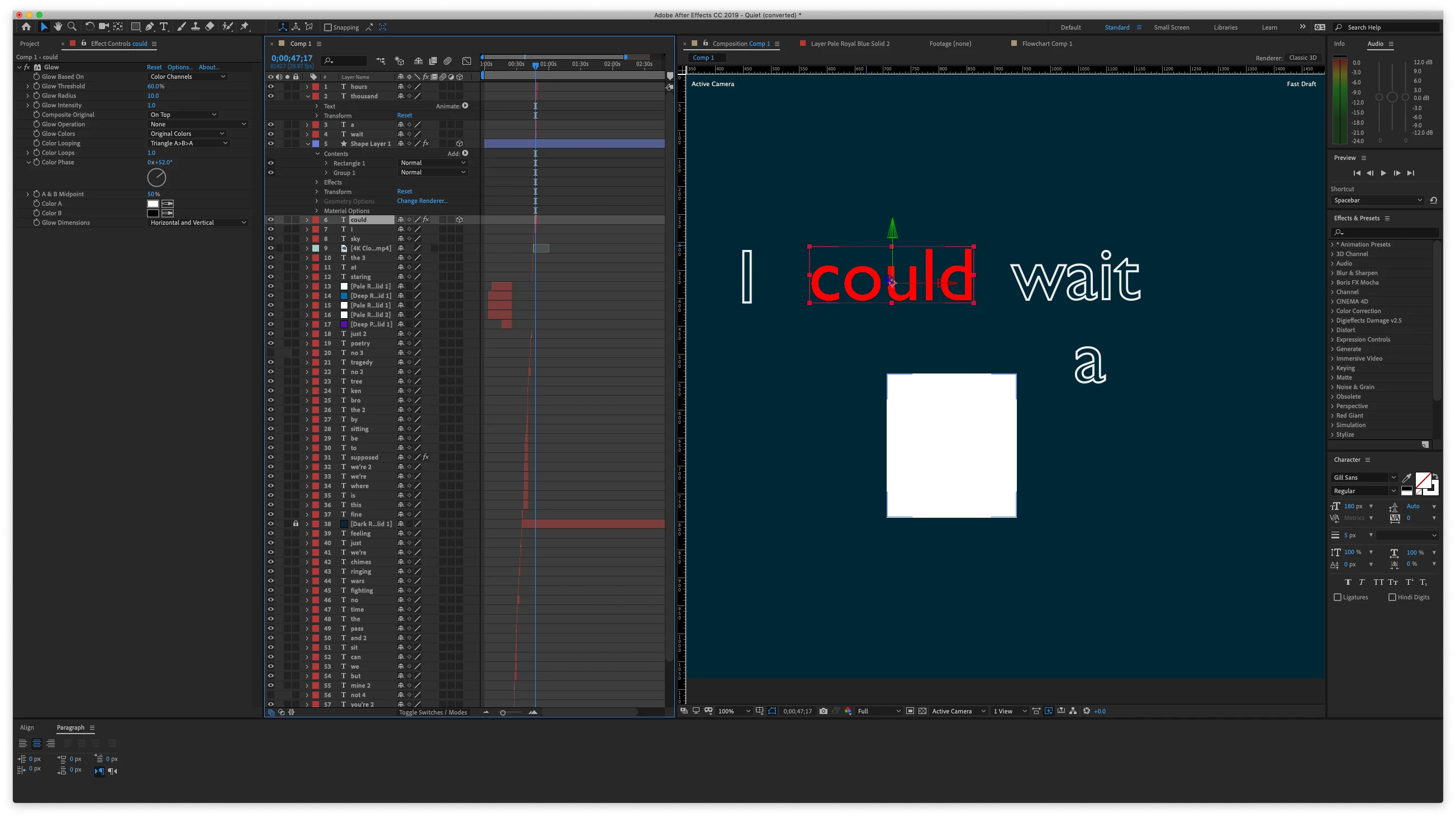

I'm making a lyric video in after effects and I'm trying to convert the text into a 3D object to use with a camera.  My issue is when the text becomes a 3D object, the text won't render with its effects (glow, blur) or outline.  It just comes up as a solid red alpha on the text.  I have it on Classic 3D for my 3D Renderer.  I'm not sure if it's something with my Mac or I installed something wrong.  I tried this with a solid layer and it renders effects just fine.  It's only the text.  I opened an old project from CS6 from my old Mac and had no issues.  Any suggestions would be highly appreciated.  Thank you!

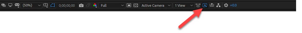

Thanks for providing proper screen shots (instead of cropped ones)   The problem is that you have fast draft enabled.
