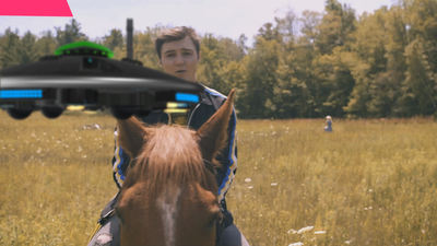

Here's the workflow to get a 3D model from C4D Lite or Element 3D into a shot that you have tracked with AE's Camera Tracker.
  • Open the shot in the footage panel and trim it to just the frames that are going to be used in the final edit
  • Open the Motion Tracking workspace
  • Drag the trimmed footage into the create new comp icon or use the "File/Create Composition from selected" menu to create a new comp from the footage you are going to track.
  • Select the only layer in the comp and run Camera tracker, expand the options, check the accuracy when Camera Tracker has finished, turn on Advanced analysis if you have any concern about the accuracy
  • Find any tracking markers that have attached themselves to objects in the scene that are moving, like the actor on the horse and delete them
  • Make sure that the accuracy goes up
  • Pick a spot in the shot where you have a good place for the origin and ground plane. This will be where you want your 3D model to be when it is at the center position of the 3D app
  • Select at least 3 points, set an origin and ground plane, then using the same target add a solid and a camera
  • Add a layer marker to the layer on the same frame you used to set the Origin and Ground Plane and add the camera (IMPORTANT)
  • Change Tracker Solid to a Guide layer and maybe add a grid and orient it so that it lines up with the perspective in the shot
  • Check the track and make sure that it is rock solid - if it is not, start over
  • When the track is good, add as many other solids (not nulls because you can't see if nulls are stuck to the surfaces) as you need for your scene and set them all as guide layers
  • Verify again that the camera track is good
  • Add a new 3D null to the comp at the top and set the position of the null to 0, 0, 0
  • Lock the original footage layer so it doesn't move
  • Parent the Camera and all the track solids to the Null
  • Reset the position of the null to Comp center by selecting all the transform properties and resetting them
  • You have just normalized your comp to AE's 3D world
  • There is one more step, add a comp sized 3D solid to the timeline and check out its size. It may be really big or really small. You will want to scale the Null uniformly until the test 3D solid you have just added nearly fills the frame. You will now have reasonable numbers to work with
  • Once the comp is fully normalized any 3D model you create will be right at comp center when you add it to an Element or a C4D layer
Now you can animate the 3D element so that it moves around in the scene. If you are using C4D to add the model you can also export the Comp as a Maxon Cinema 4D file and bring in all of the reference solids as placeholders to help you orient the model and animate it in C4D. All of your added solids should be guide layers and may be turned off. It is a good idea to lock them so you don't inadvertently move them. If you need to add additional reference solids you need to return to the layer marker (this is also probably the only place in the comp where the 3D model is centered in the frame), then move the 3D null (the parent of all the 3 D layers) back to 0, 0, 0 and set the scale back to 100%.
There is a Pay what you want Script that will do all of this for you that you should look up if you are going to do a lot of this stuff. You should also get used to looking at at least 2 views so you can see how the camera relates to the other layers.
Let me know if you have any trouble. Here's a link to the script that I use to Normalize every shot I camera track. The site has a good tutorial that goes through the steps I outlined.
NOTE- This doesn't work on Tripod Pans because they have no depth info.
If you do not set an origin and ground plane, and you do not normalize the comp the camera could be pointed anywhere. If you normalize the comp; then
