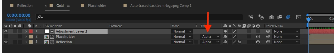

Hi! I need help!
When i want to make a Adjustment layer it is white (not transparent)
Hot do i make the Adjustment layer it self transparent?
[NOTE]
The blending mode isn't helping!
Please if someone know what to do!
Thanks.
Correct answer Andrew Yoole
Mylenium is correct.  You have an Alpha Track Matte set on the layer below the adjustment layer.  This means Layer 2 is taking the alpha channel from the layer above - which is probably nothing.  You also have Layer 1 using the alpha channel of Layer 2.
This makes no sense at all.  Try turning off the Alpha Track Matte setting, especially if you're not sure what they're doing.
August 7, 2021
Alright i will check! Because im following a tutorial and this is exactly how they have but the Adjustment layer is transparent for them.

Your adjustment layer is used as a track matte, by two layers at the same time no less. This simply cannot work. I would suggest you actually read the online help on such basics before modifying what appears to be a downloaded template or blindly following a tutorial.
