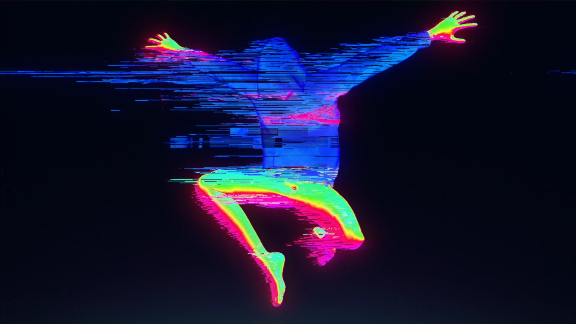

 I render my composition with ProRes to a MOV file.  After I import the rendered MOV file back into AE and put it into new composition, the preview of it is significantly darker than the composition from which I rendered the MOV.
I've compared the same frames from my MOV renders with AE preview of the composition  by importing the MOV to Photoshop and rendering the composition frames in AE with "save frame as" option. They are virtually the same so I know my MOV file is fine. The issue is, when I import it back to AE, it seems as if AE was tinkering with it's gamma..
I'm attaching 2 images:
First one shows the MOV frame / Composition frame "save frame as" screenshot (they are the same so just 1 file is enough)
Second one shows the same frame from the MOV file after importing it back to AE.
Any ideas why is that happening? I've switched between 8/16/32 bit color depth, but that didn't resolve the issue.

You may want to read the online help on some basics. Right-click on your footage in the project window to check footage interpretation and check the color management under File -> Project Settings. Proof previews work at the comp level. Again, all explained in the help.

Footage interpretation -> Color Management -> Assign profile. It was set to Rec.709 Gamma 2.4, while sRGB is 2.2. Thank you for your help, I appreciate it.

Without any info about the actual CoDec in the MOV, render settings, footage interpretation your color management settings, system info and al lthat none of this has any meaning. Traditionally this has always been an issue since some CoDecs use a different Gamma and it's really not AE's fault plus of course exporting some formats will also hard-change the color ranges doe to how their compression works. Doing a difference overlay on your image suggest exactly that 0.2 Gamma difference that happens when you don't interpret the footage correctly, so that would be the first place to check. Anything more will require more precise info.

Ok, here's additional data. I'm using ProRes - I've made this test with 422, 422HQ, 4444, best quality setting, depth: both trillions and millions of colors. As said earlier, the MOV file itself renders the same vs the frames saved from the preview in AE - the gamma is being altered when the MOV is imported back to AE. Yes, color management settings could be the culprit, but I don't see such a panel in AE? At least not an obvious one like the one in PS. What options should I be looking into? Thanks
