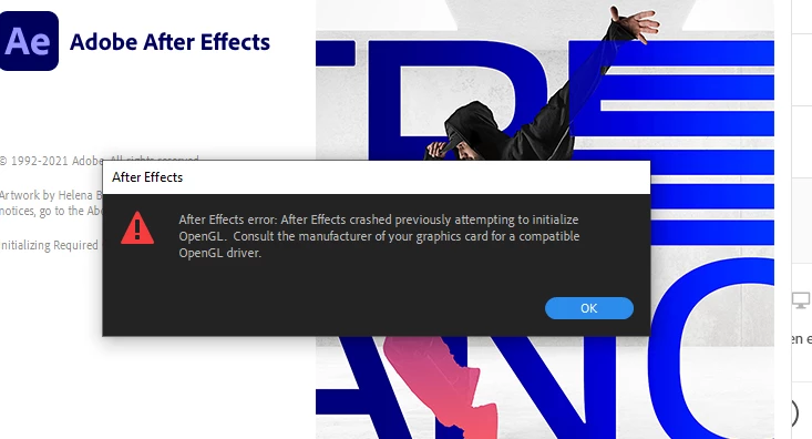

Hi Video heroes!
Can someone please help met with the following problem!?
I have installed all possible OpGL Drivers I found for my G force but I still get the following message:
Thanks in advance!
Elina

Hi Nishu,
The problem is solved!
It had to do with the docking station (a colleague of mine found out).
When I connect my laptop to the docking station, then it swiches to the
videocard of the docking station.
Regards Elina

also try reinstalling after effects and gpu drivers

Hi Elina,
sorry for your issue.
If Rick's suggestion doesn't help, please share the following details:
Let us know.
Nishu
June 29, 2021
Hi Nishu,
Rick's solution does not work.
These are my system specifications:
The progam gives the error at launch.
Thanks in advance!
Elina

Hi Nishu,
Regards Elina

First, try holding down Shift + Alt/Option + Ctrl/Cmnd when you click on the After Effects program icon to reset your preferences. If that does not work try turning on the Caps lock key so that AE does not try to render anything when it launches. If that does not work make sure your system meets the minimum system requirements for After Effects.
It might also be helpful if we knew something about your OS and your system.
