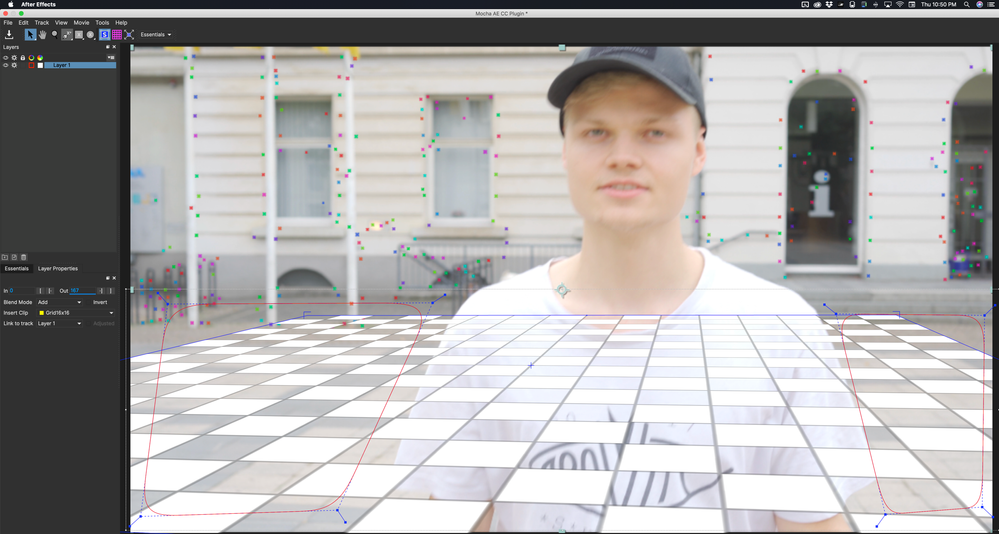

There is another option. Corner Pin Track the floor in Mocha AE making sure to have perspective selected. Verify the corner pin track in Mocha AE is valid by adjusting the surface and adding a grid. Make the surface as large as possible. When you get the corner pin track done in Mocha apply it to a solid layer in AE, then add a grid to the solid layer. Make Adjust the grid so you get a nice contrast (Grid must be above Corner Pin). Now Precompose that and Run Camera Track on the nested comp. This will give you the original background which already gave you some geometry and an accurate fake floor with a grid that will give you the detail you need to get camera track to work properly.  Mocha looks like this: Two Splines on one layer + the surface adjusted to match the perspective on the floor and then expanded to include all of the floor, and a grid applied to check the accuracy of the track:
Then back in the main comp corner pin is applied to the grid to give you some detailed geometry and hide a lot of the actor's body from the trackers.
I've used this technique a bunch of times and it works very well.
